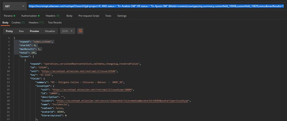

I have the following query: https://accnetopt.atlassian.net/rest/api/2/search?jql=project=IC AND status = "En Analisis OM" OR status = "En Ajuste OM" &fields=created,issuetype,key,summary,customfield_10048,customfield_10029,status&maxResults=1
This is the result:
I just want to get all starting by the "issues" field.
Is that possible?

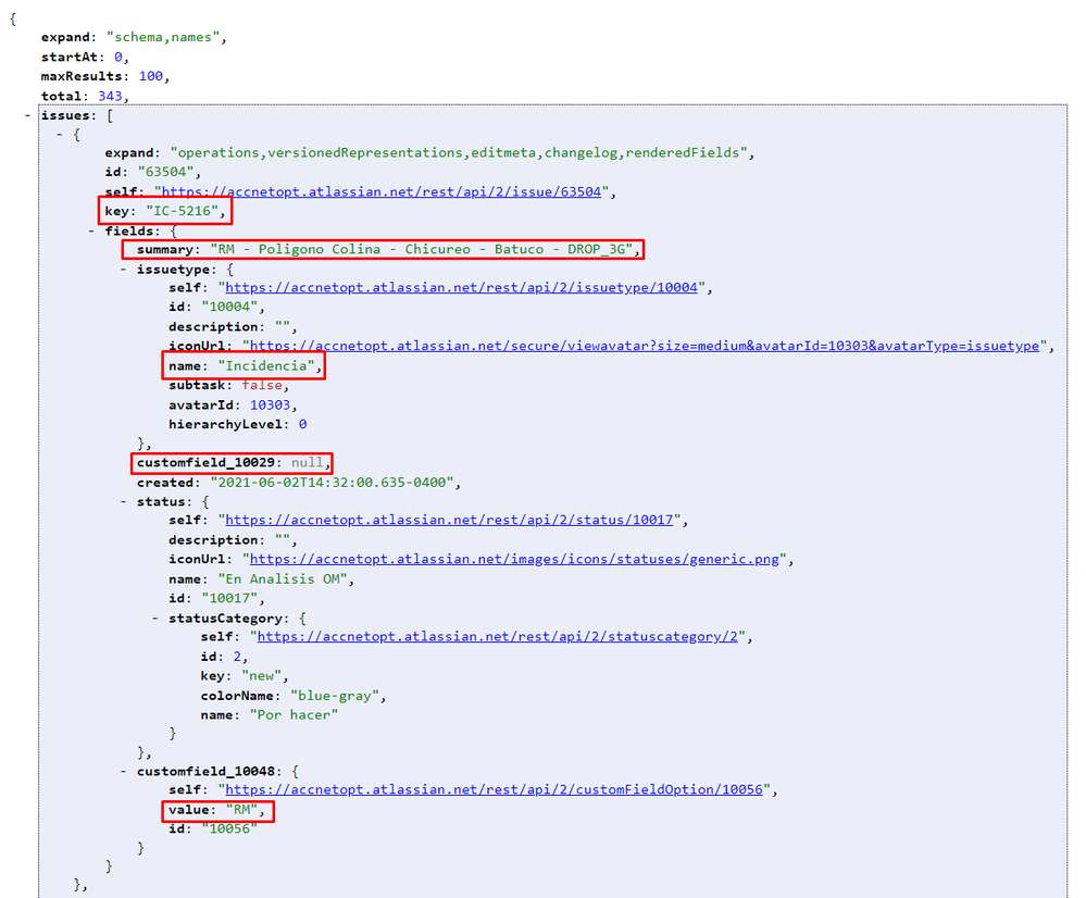

Firstly, i make a query to get the results (330)
Then i make all the needed querys to get all rows (Using startAt) (0 - 100, 100 - 200, 200 - 300, 300 - 400).
Then with a PHP script, i'm having problems to foreach the array to get this keys values:
I thought, deleteing the first part it would be easier to reach that. maybe im wrong :/
