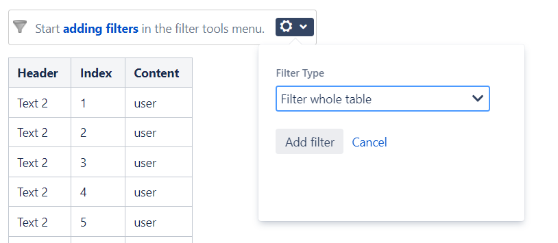

If the question is how to apply the "Filter the whole table" option, then the first step is to add the Table Filter macro on the page (insert it from the Page View mode or wrap your table in the Table Filter macro directly in the page Edit mode) and then choose this option from the available filter types:

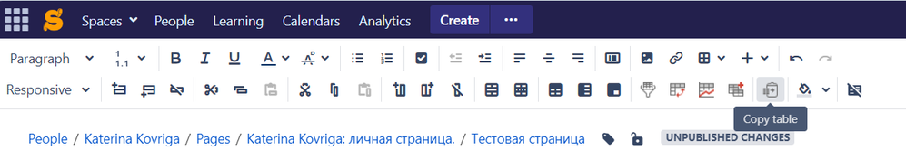

Insert the macro on the page at first (like you do with other macros, for example, Expand macro and so on).
Then copy your table to the clipboard (if your tags are correct and you are on Server/Data Center, you'll have a special button for it):
Then place the mouse cursor inside the Table Filter macro and paste the table.
