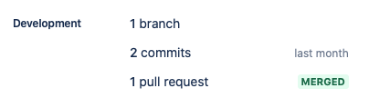

On some of my next-gen Jira Cloud projects, cards on the board display icons indicating the status of Pull Requests and other development information. For example, the Pull Request merged icon in bright green in the middle of this screenshot:
Card Front on Board:
Development Information in Card:
However, on another of my boards, the icons representing pull/merge requests do not show at all, even though inside the cards the development information all shows up correctly:
I've looked everywhere and cannot find any instructions on how to enable this feature for a given board (or, indeed, disable it!). It's a very useful feature for quickly assessing whether PRs have been merged up or not, so I'd really like to find out how to turn it on!
Thanks in advance for any advice/pointers.

Here's one possible answer, from Jira's page on the topic:
Development icons will be displayed on your board as long as one or more issues on your board has development data linked to it and your board contains less than 100 issues.
The board I had this problem with had 103 issues on it. As soon as that dipped below 100, all of the Development Icons appeared.

Hi @Alexander Dowding  -- Welcome to the Atlassian Community!
Have you checked in Project Settings > Features > Code to see if that option is enabled?

Yes, Project Settings > Features > Code is enabled, and we can see our GitHub commits in the "Development" sub-panel of the card, as noted above. I've compared all the settings I can see between the project where this feature works and where it doesn't, and I can't see any differences. Quite the conundrum.
