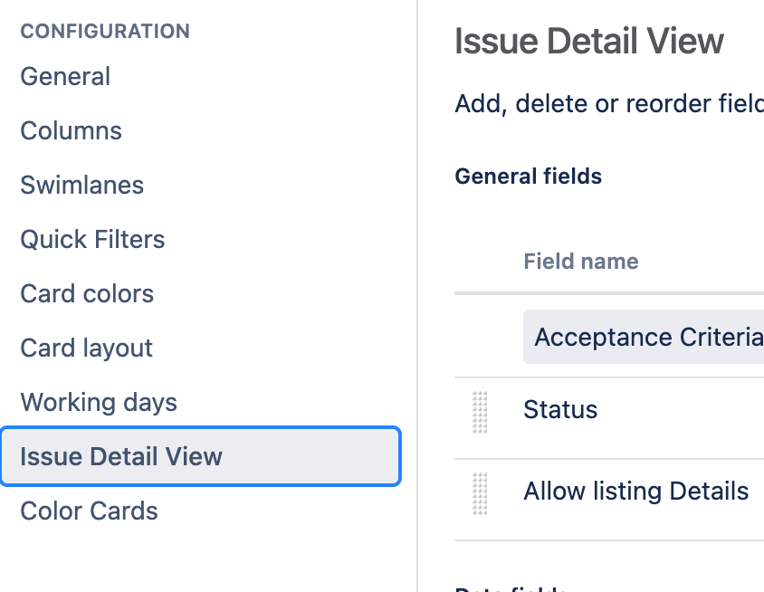

Janet
October 6, 2022
It is under Board, Configure,  Issue Detail View

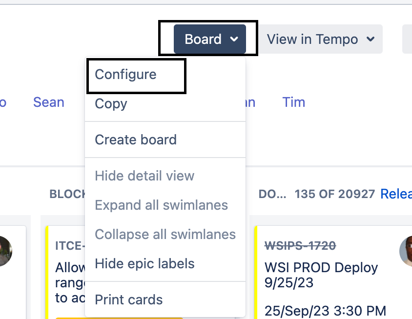

Janet
July 9, 2024
Hey Dinesh - its not in that menu its under your KANBAN Board menuScreenshot 2024-07-09 at 12.46.12 PM.pngScreenshot 2024-07-09 at 12.47.44 PM.png
