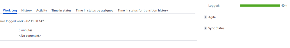

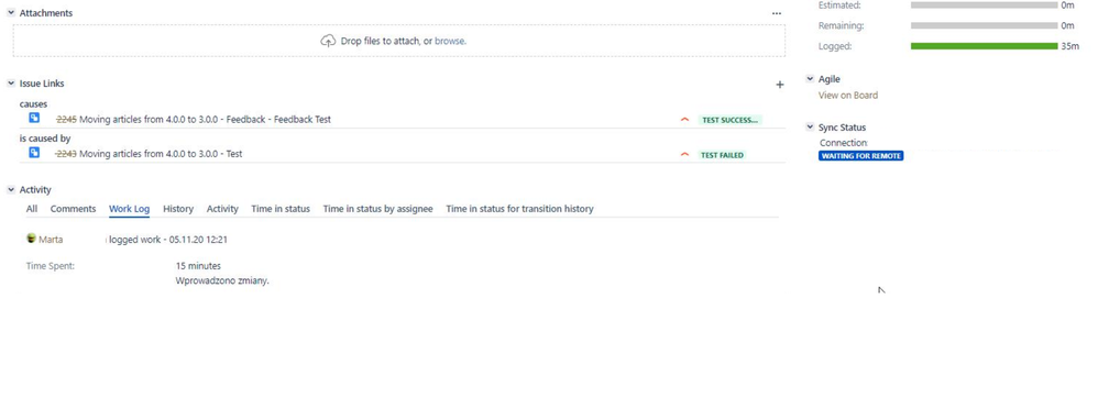

Every subtask created by workflow multiplies logged time in my project. Here is an example:
As you can see in this particular issue, there is only one record with logged time - 15 minutes. But in the top right corner of the screenshot, it states that there are 35 minutes logged - those remaining 20 minutes are from an issue that triggered the creation of this one.
And now, here is the question - how to delete that 20 minutes?

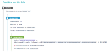

If you want to just reset issues to a time spent of 0, you could use a manual rule like this (replacing the JQL 'project = DEMO' with the one that matches your scenario, e.g. the affected sub-tasks):
A more elegant way would be a manual rule like this (again replacing the JQL):
The expression used is:
timeLogged(issueKeysToIssueList(%{selector.issue.key}),{selector.issue.created},{system.currentDateTime}) / {MINUTE}
This rule updates the total time spent to the sum of all time logs done after ticket creation. Additional hint: if you use 'key = ABC-1' as the JQL within the selector, you can test the whole thing on a single issue before doing a bulk update.

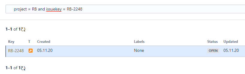

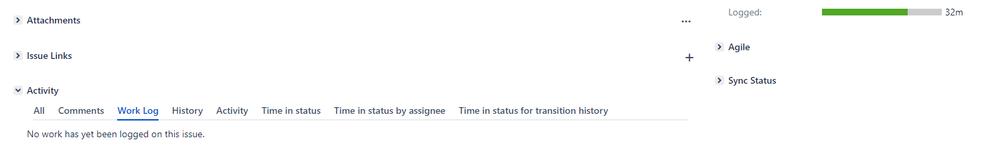

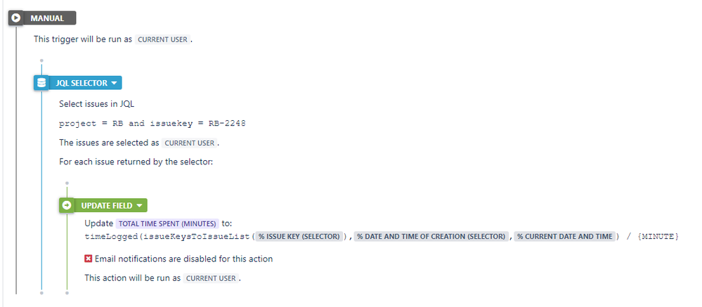

Unfortunately, it does not work for me. On my side, it looks like this:
image.pngI'm sure that expression works, as I've tested it in Jira search engine:
There is no change. I've tried it on few issues to be 100% sure :)
