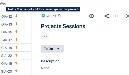

How to edit Issue type? Why I'm not be able to edit?
Muhammad Waqas Osmani
May 14, 2020
Error: "Task - you cannot edit this issue type in this project"
Why this error occurred and why I'm not able to edit?
Nic Brough -Adaptavist-
May 15, 2020
Issue type is not just a field, it's one of the two things that all the configuration hangs off.  Changing the issue type can be a massive task.  You're not just changing a bit of text on a post-it note, you could be trying to change a bicycle into a zebra.
The warning you see here is happening because the issue types are configured differently.  Try using "move issue" instead - that has code that compares the setup of source and target and asks you to fix any incompatible data as you change from one type to another.

Hi @Muhammad Waqas Osmani
I am unsure about this error hence if this is tied to just a single issue type in the project then it is possible there is a workflow property in place restricting who can edit issues.
Check this with your jira administrator (especially if the workflow for the Task issue type is different from others).
