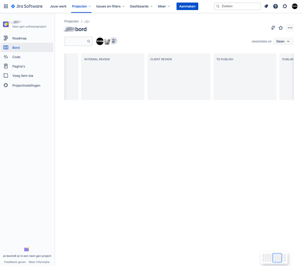

Thinline
November 17, 2020
Hi @John Funk
can't see any 3 dots with "copy" functionality...
John Funk
November 17, 2020
Ah, it's a Next-gen board. No, unfortunately, you cannot copy Next-gen boards.

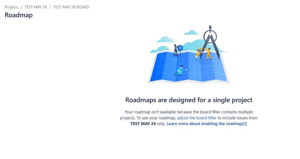

Kristine Gemici
May 24, 2022
Hello John and thanks for the quick response! I first created a template project with the appropriate settings... Then I created a new project while copying the settings from that template as a "company-managed" project . Then I went into the View all boards area and copied my template board and renamed it. I then went into that board and tied it to my new project. This is the error I received.....
Is there a better way of doing this?

Kristine Gemici
May 24, 2022
Yes, the original is a "company-managed" project...  For the roadmap, I get the same error unfortunately....
Do you happen to know where I can find a step by step guide on how to copy a board to a cloned project? Or did I follow the right steps but maybe something is wrong with my settings somewhere?

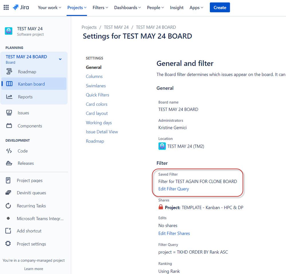

Kristine Gemici
May 24, 2022
Thanks John!!! How did you change the filter? There must be something in that step that I do not fully understand...
I followed the steps about but I am getting stuck at the filter part I think ... Please see the screenshot below to explain where I am at... What should I enter for the filter?
John Funk
May 24, 2022
Click on the Edit Filter Query link
Change the filter to use the new cloned project.
Save that and share it if need be.
Then go back to the board.
You have to click on the actual filter name of the old one - that will put you in a search mode to look for the one you just created.
Select it and it should be good
Like Kristine Gemici likes this

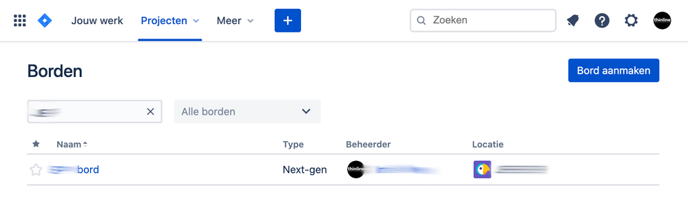

Thinline
November 17, 2020
Hi Cemal,
Don't have those... The dropdown list is for grouping. The 3 dots only say "Manage workflow", which brings me to the editor.
