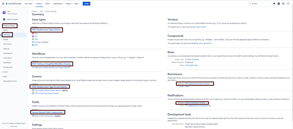

For this you can use the same configuration of Project A to Project B
- You should know which Proj Configuration scheme is used for Project A
- Then Go to the Project Setting of Project B > Click on Summary
It will look like this
- Here you need to replace the mark scheme to the Project A scheme.
- Click on each scheme > Select Action > Select Use Different scheme option
In this way you can replace Project B configuration by Project A configuration

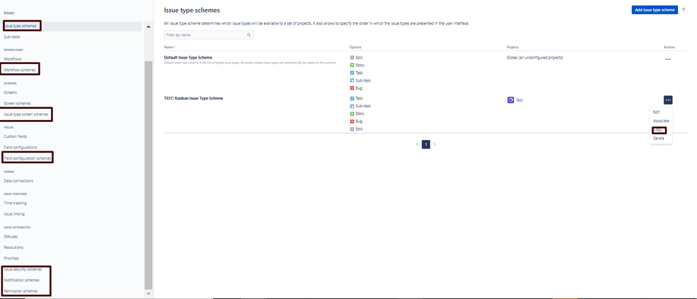

Or You can make a copy of Project A configuration  and then use to Project B
- First you need to make copy of configuration scheme of Project A
This can be done from  Jira Admin Section > Issues
Make a copy of scheme which is used for Project A
Once All scheme copy done then Go To the Project Setting of Project B and then apply this copy scheme to Project B by using above steps.
