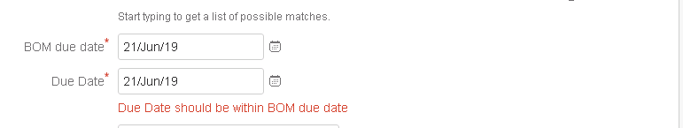

Hi Martin,
Thanks for the script above.
When I test for same date, error message is displayed. Please see screenshot.
I think the problem is that you're using Date field which does not save time part of the date (which is correct) but new Date() creates date with current time. So instead of new Date() try to create Date instance with one of the methods mentioned here:
https://www.baeldung.com/java-date-without-time
For example:
publicstaticDate getDateWithoutTimeUsingCalendar() {
Calendar calendar = Calendar.getInstance();calendar.set(Calendar.HOUR_OF_DAY,0);
calendar.set(Calendar.MINUTE,0);
calendar.set(Calendar.SECOND,0);
calendar.set(Calendar.MILLISECOND,0);
returncalendar.getTime();
