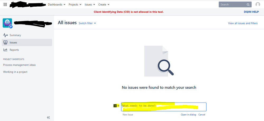

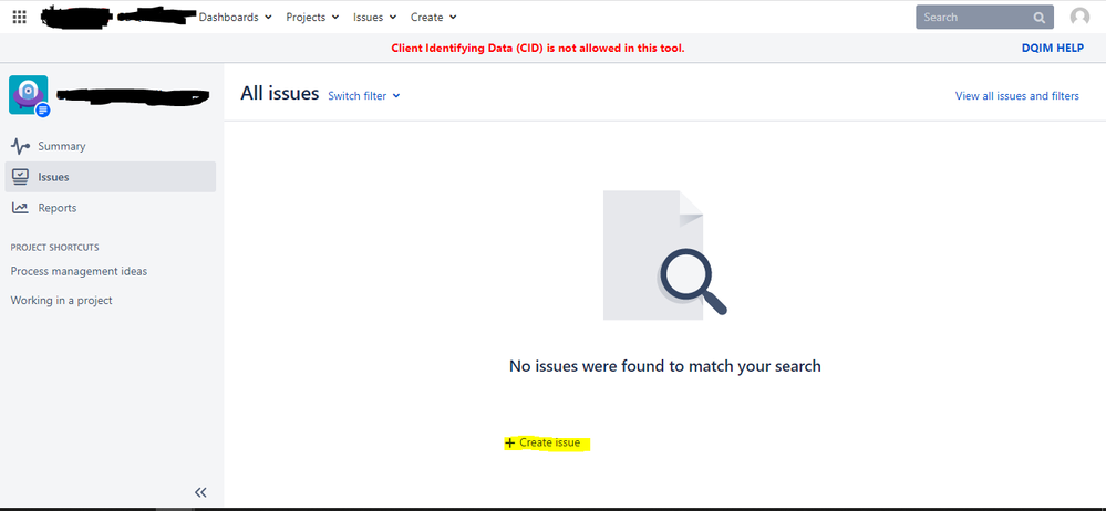

I am also facing same problem due to this "+ Create Issue" button in projects sections. This button is creating issue bypassing mandatory fields. We are using Script Runner plugin for the customfield behavior using groovy scripts.
This is a challenge for us, few users created issue using this button by mistake and ended up having no mandatory fields populated.
This project is a "Company Managed project", but if you can let me know how to get this property of project.
We have customized JIRA to accommodate with our requirement of work flow management tool.
We are using "Atlassian Jira Project Management Software"
Please suggest us any work around or any solution to disable this "inline issue creation" block.

Nic Brough -Adaptavist-
July 1, 2022
There is no reason to do this.
The "create issue" button does not "bypass mandatory fields" unless you've kludged "mandatory" into the system in the wrong way.  If you have used the field configuration or a validator to make your fields mandatory, then this "create issue" route will respect that.
If you insist on doing it this way, you also need to look wider than getting rid of this button - the url it pops will still be usable, the REST API is another route, if you've got JSM, requests can bypass it, and there's a couple of incoming email routes.
I don't think removing the create link here is the right thing to do.  You should be making the field mandatory in the standard way.
July 5, 2022
No, it's not possible to hide it (reliably).
 Changing the configuration of the fields won't hide it, but it will stop your problem of "lets people bypass mandatory fields", which means there's no reason to try to hide the button.

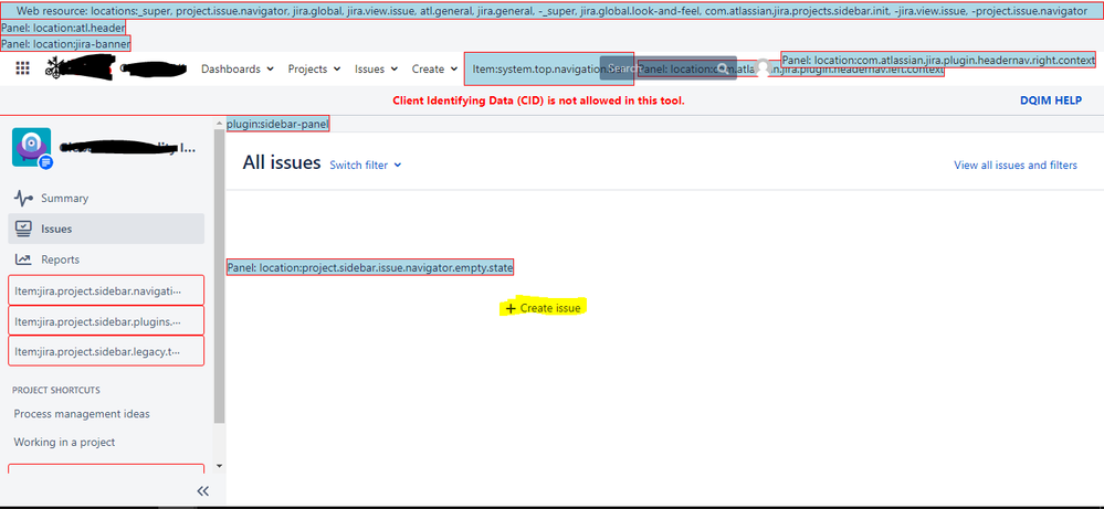

      3. There is no fragment found for "+ Create Issue" using Fragment locator. Below is the screenshot.

Sambit Choudhury
June 30, 2022
I have tried javascript approach in announcement banner but it's behaving inconsistently, sometimes when I refresh page it again shows up.
If you can let me know which UI element is this "+ Create Issue" in projects section. So that I can try hiding in Fragments.
