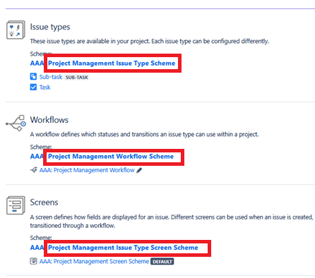

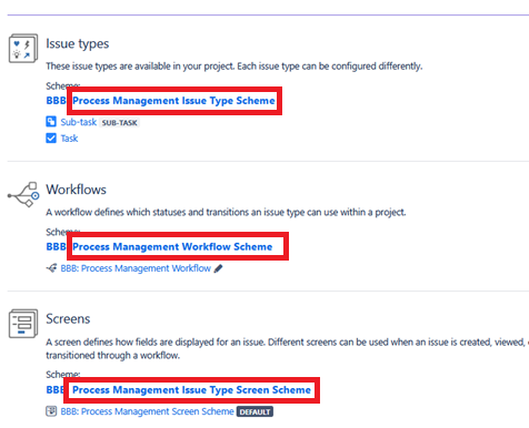

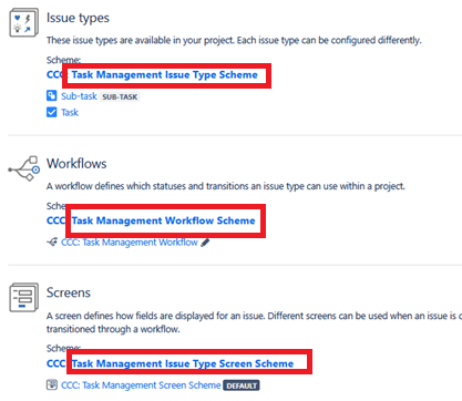

If you go to the Administration Menu > Projects and enter to one of the projects You can see the Issue type scheme, Workflow Scheme and Issue type Screen Scheme.
  • By default projects from Project management template has the following name patterns:
  • By default projects from Process management template has the following name patterns:
  • By default projects from Tasks management template has the following name patterns:
