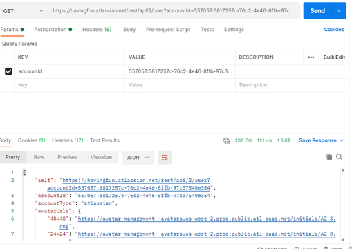

Hey @Charlie Misonne
I'm using postman+JS but I first started with postman in order to see that actually works before iterating through all the users.
This is the GET which does respond correctly:

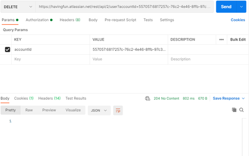

But when I try to delete it:
it doesn't show anything and it didn't delete the user.

Hey thank you for the quick response, It didn't work either.
Well that's odd. In your screenshot I see you get a 204 response and that should mean the user was removed successfully.
