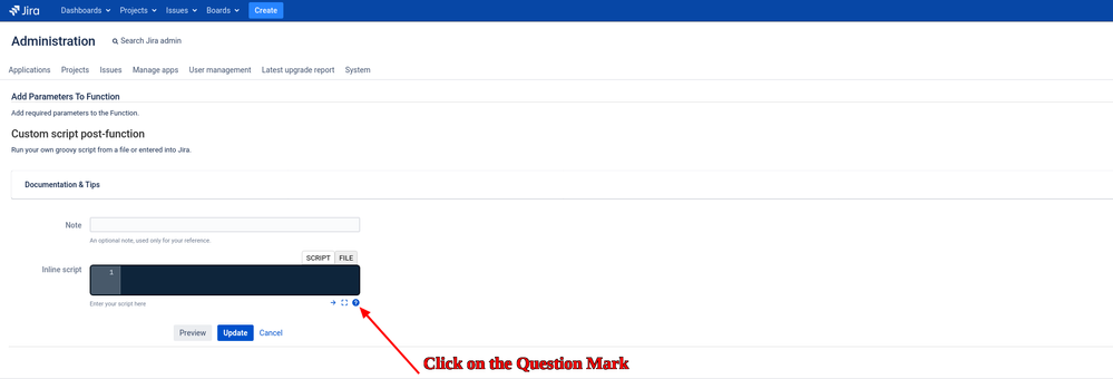

To see which keyword you can use, click on the question mark symbol as shown in the image below:-

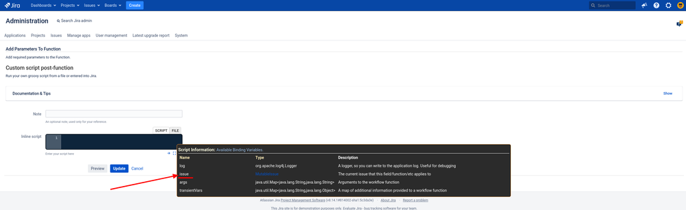

Once the question mark symbol is clicked, you will be shown the in-build variables as shown in the image below:-

put("/rest/api/2/issue/${issue.key}")
I hope this helps to answer your question. :)
