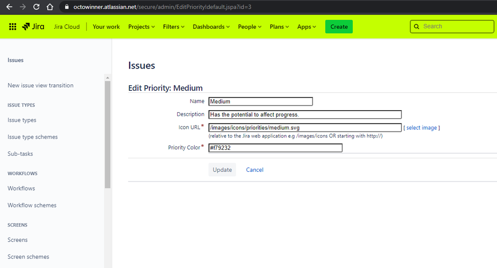

https://your-domain.atlassian.net/CreateIssueDetails!init.jspa?pid=10012&issuetype=10007&priority=3&summary=test
Have the IDs of issue type and then place them in the URL.
Issue type id will come in thousands and priority in single digits, please check that.

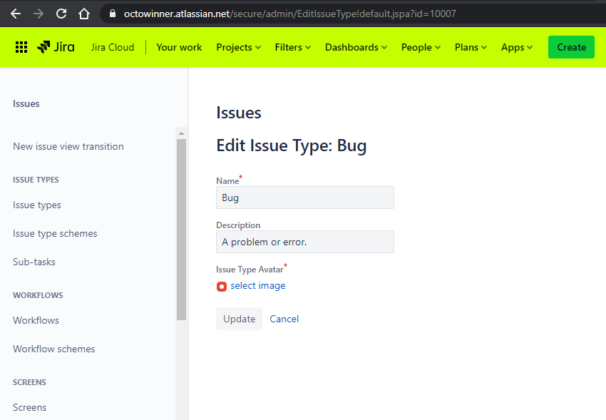

I just can't find what ID to use for Issue Type = Bug
Pramodh M
February 26, 2021
Please go to the administration page and edit the bug issue type, you will get to know the id in the URL.
Michelle May
February 26, 2021
I appreciate everyone's response. I found the Bug ID by using the "export" option, select "xml" then type id for Bug = 10102
