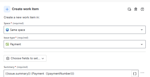

I have a purchase work item (epic - level 1) and based on the number of payments (numeric field) at some point an automation it is triggered to generate the child work items (tasks - level 0) that represent the number of payments. So if the # of payments field is 3, 3 work items will be created with the summary Payment 1, Payment 2 and Payment 3

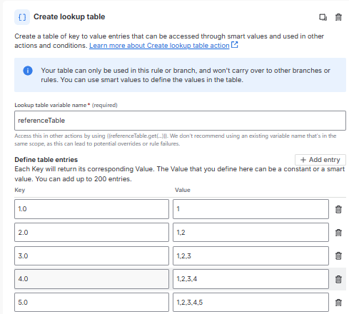

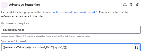

In order to dynamically create the child work items, I'm using a lookup table as suggested here: https://confluence.atlassian.com/automationkb/automation-rule-looping-on-a-numeric-value-in-jira-automation-1416563126.html
and it works well. Creates as many issues as the integer in the field. The problem comes with how Jira seems to handle loops and branches, and the issues are created out of order.

Automation for Jira is handling the branch (the for-each-component) as multi-threaded, so when you create an item in a branch you will not be able to control the order in which they are created.
You might do this by using calling a web request automation rule. But only when the number of fields that you need to update are limited.

given the limitations due to the way Jira handles parallel issue creation, if the numeric field has a known maximum value (e.g. the maximum number of possible payments is 5), you could try creating the tickets sequentially using an automation with multiple IF conditions.
This is a somewhat dirty workaround, but it is the only one that forces Jira to execute the actions sequentially. I tested the following rule and it seems to work.
When: Issue created
If: customfield_10471 is greater than or equal to 1
Then: create sub-task – $issue_key$ Payment 1
If: customfield_10471 is greater than or equal to 2
Then: create sub-task – $issue_key$ Payment 2
etc.
Important: use If and not Else if
Warning: if other tickets are created while the automation is running (3–5 seconds), you may lose sequentiality at the issue key level.
