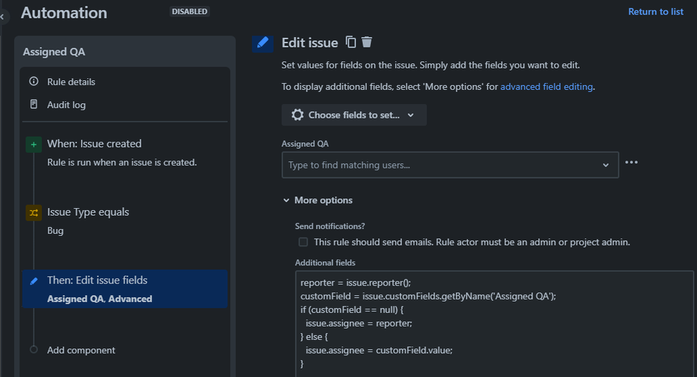

snehil.mishra
July 17, 2023
Sorry I missed to share the screenshot earlier. I set the rule but it is not working.
Logic I added
reporter = issue.reporter();
customField = issue.customFields.getByName('Assigned QA');
if (customField == null) {
issue.assignee = reporter;
} else {
issue.assignee = customField.value;

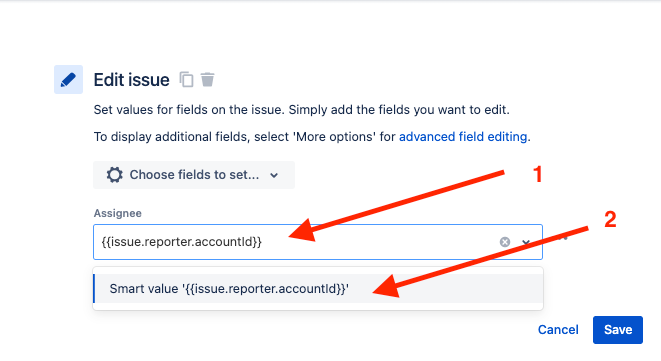

Trudy P Claspill
July 17, 2023
Hello @snehil.mishra
When you use the More options to edit a field it is expecting JSON code. Refer to
https://support.atlassian.com/cloud-automation/docs/advanced-field-editing-using-json/
Additionally, when you use that option you don't select the field from the pull-down list above.
But you don't actually need to use that option at all.
Instead, modify your rule as follows:
Keep the Trigger and the Condition to check the Issue Type.
Remove all the code that you added under More Options
Click into the field value entry space under Assigned QA (1). In my example screen I chose Assignee because I don't have an Assigned QA field.
Type in the smart value to get the account ID from the issue's Reporter field (1).
After typing in the smart value, click the area below where is says Smart value '{{issue...}}' (2). Clicking there will finish inserting the smart value into the value entry field.

snehil.mishra
July 17, 2023
Thanks for your quick responses. It is working fine.
