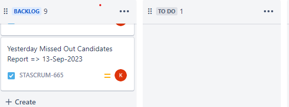

prabhu
September 13, 2023
@Trudy P Claspill
I guess I have confused with boards and status. The above picture will explain that I want my ticket to create in TO DO instead of Backlog. Apologies for the confusions.

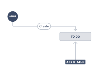

Additionally when you look at the workflow, you should see that the Start point and the Create transition lead to a gray status.

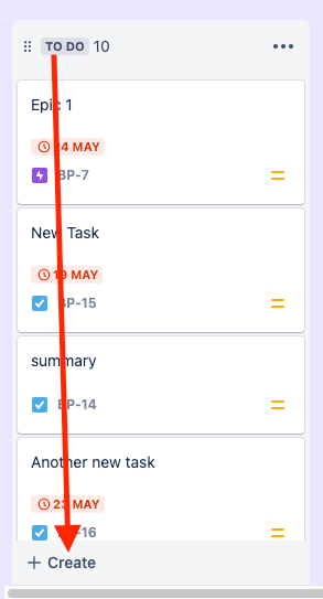

The status pointed to be the Create transition will be the same status in your board that shows the +Create option at the bottom of the column.
Now, looking at the image you provided, I see that the +Create option is at the bottom of the Backlog column, and that status is blue which indicates it is part of the In Progress category. I recommend these changes.
1. If you want issues created in the To Do status, modify the workflow so that the Create transition points to the To Do status rather than the Backlog status.
