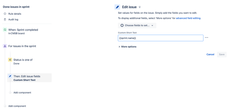

Trudy Claspill
January 27, 2023
Hello @Felipe Felix Braga
Welcome to the community!
I haven't yet figured out how to solve this for issues in past sprints, but I have an idea that might work going forward.
This requires at least one Automation Rule, and either a second Automation Rule or an update to the workflow.
My solution is for you to have a custom short text field in each issue to store the name of the Sprint in which the issue was completed.
You would use an Automation Rule to set this field for all Done issues when a Sprint is completed.
You would need a second Rule or modifications to the workflow(s) so that if the issue was reopened sometime after sprint closure then the custom field would be cleared.
The trick for issues already Done in a sprint that is already Completed it that the order the sprints print out is not necessarily the order in which they were completed.
JQL is not designed to retrieve information about a sprint, but rather to retrieve issues, so that can't be used to figure out which sprint was Completed last. v3 of the Jira REST API doesn't appear to have an endpoint for pulling information about a sprint. I'm still looking to see if there is a solution in an older version of the REST API.
