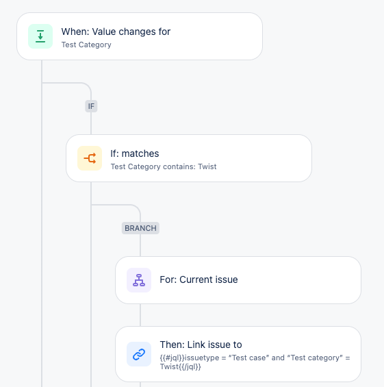

Our team is trying to create a JIRA built-in test case management tool. So we created two issue types called Test Run and Test cases.
We have also created a new field called Test category where you can select multi-values from a dropdown list.
We wanted to create an automation rule where if the Test category field is updated by a user for the Test Run, it should link all Test cases having the same value.
Sample:
User updates the Test category field of QA-1 with issue type "Test Run" with the values Twist.
Automation rule should link issues TC-1, TC-2, TC-3 with issue type "Test cases" to QA-1 as TC-1, TC-2, TC-3 all have values "Twist" in their Test category field.
Here's a sample flow but with hard-coded values:
`{{#jql}}issuetype = “Test case” and “Test category” = Twist{{/jql}}`

Hi @E R
Something like this should work:
  • Trigger: Field value changed
    • Field = Test Category
  • Branch: Related Issues
    • Type = JQL
    • JQL - issuetype = "Test Case" and "Test Category" = "{{triggerissue.Test Category}}"
      • Branch-Action: Link Issues
        • Type = Link Type Here
        • Issue = Trigger Issue
This is a dynamic version of your rule - the {{triggerissue.Test Category}} smart value populates the JQL query with the value found in the trigger issue, rather than needing it hardcoded into multiple IF/ELSE rules.
Once the Branch finds all relevant Test Cases, you can then execute the action against each of the TC issues to link them back to the Test Run.
Let us know if this helps :)
