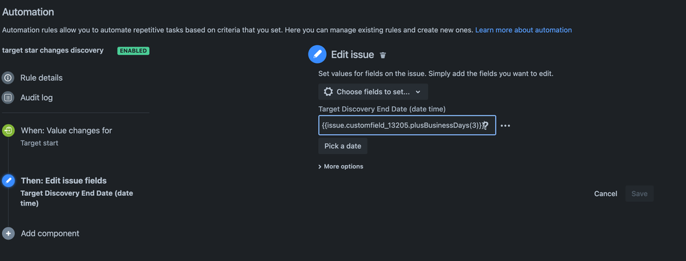

I set the "Target start" to 13/Jan/26.
Using the expression {{issue.customfield_13205.toDate.plusBusinessDays(3)}}
The "Target Discovery End Date" displays 16/Jan/26, which is correct.
Using the expression {{issue.customfield_19809.plusBusinessDays(3)}}
The "Target Define End Date" displays 20/Jan/26, which is not correct; it should display 21/Jan/26

Next, what I believe is happening is you are changing one field, then trying to use the updated value in a later rule step.  When you want to do that, the rule needs to add a Re-fetch Issue Data action to reload the information.  For example:
  • action: edit issue, to update the "Target Discovery End Date"
  • action: re-fetch issue data
  • action: edit issue, to update the "Target Define End Date" (based upon the earlier change)
After doing that...please post an image of your current, complete rule and the audit log details showing the rule execution.  Thank you!

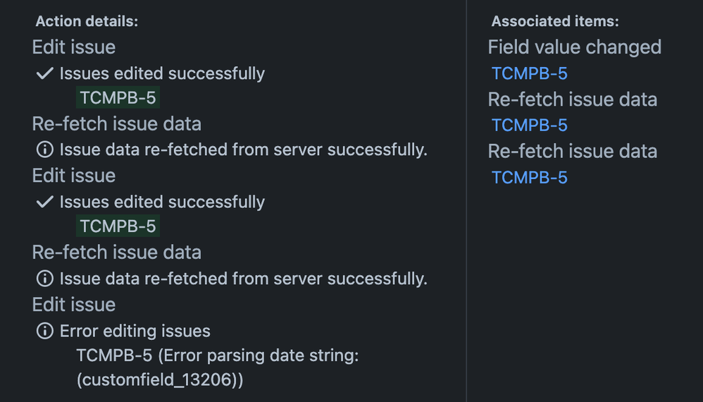

Shahriar
November 13, 2025
Hi @Bill Sheboy ,
Adding the re-fetch issue data action did the work! Thank you again so much!

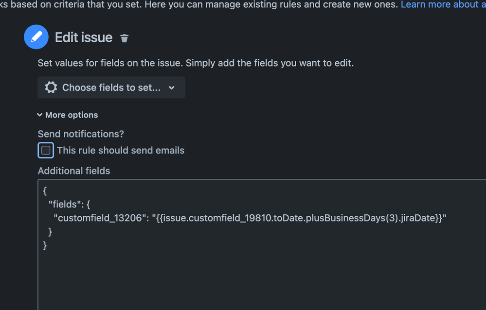

I have one more problem with the very last field.

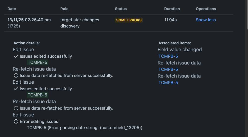

My very last field is the "Target end", which is the field that came with JIRA Plan/Roadmap, just like "Target start".
I am trying to get that field to display 3 days after the previous date field in my rule, which is the "Target Define end", but I am having difficulty writing the expression.
Here is what I have, but it keeps giving me parsing and JSON errors.
I tried several ways, but no luck:
{"fields": {"customfield_13205": "{{issue.customfield_19810.toDate.plusBusinessDays(3)}}"}}
{"fields": {"customfield_13205": {{issue.customfield_19810.toDate.plusBusinessDays(3)}}}}
{"fields": {"customfield_13205":[{"issue.customfield_19810.toDate.plusBusinessDays(3)"}]}}
Thank you so much in advance! Much appreciated!
Screenshot attached from the audit log.
Like Bill Sheboy likes this
Bill Sheboy
November 13, 2025

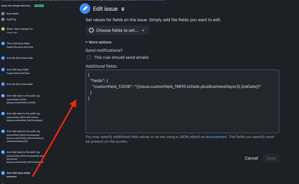

When using JSON to update a date field for a rule, the value must be text in the jiraDate format.  Please try this for the JSON expression:
"fields": {
"customfield_13205": "{{issue.customfield_19810.toDate.plusBusinessDays(3).jiraDate}}"
https://confluence.atlassian.com/automation/advanced-field-editing-using-json-993924663.html#AdvancedfieldeditingusingJSON-Datepickercustomfield

Hi @Bill Sheboy , I tried using the JSON expression you provided, but it didn't work. I get the parsing date string error in the log. I will provide a screenshot.
I made a mistake in my earlier message and expressed it with the custom field ID, but that isn't the problem. The custom field ID for the Target end is 19810
Thank you so much for your help!

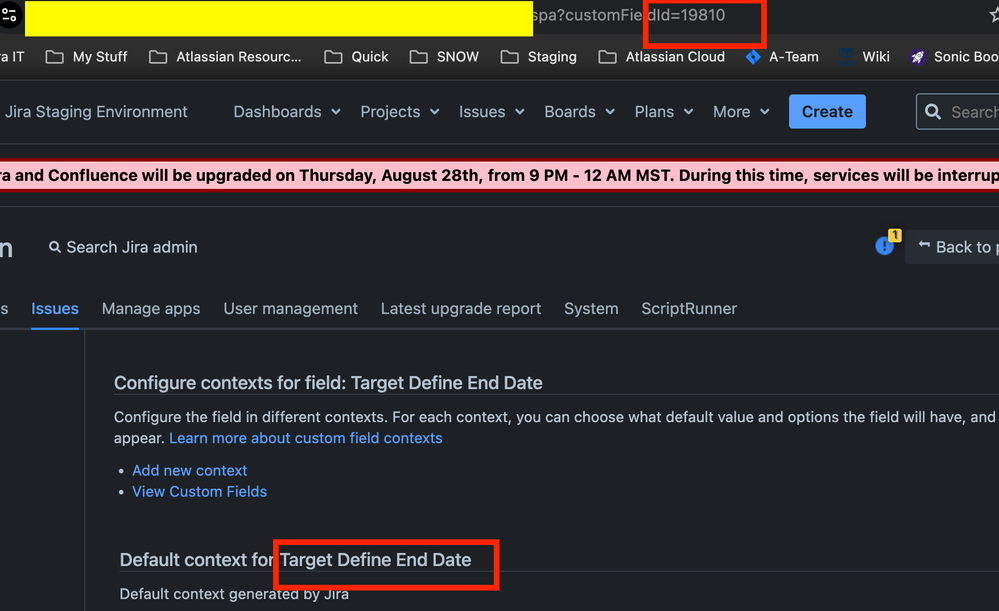

Bill Sheboy
November 14, 2025
First, please confirm the custom field ID.  Earlier you noted it was customfield_13205 and now you show a rule with a different one: customfield_13206.
Next, please show an image of your complete rule and an image of the edit issue action for that last custom field.

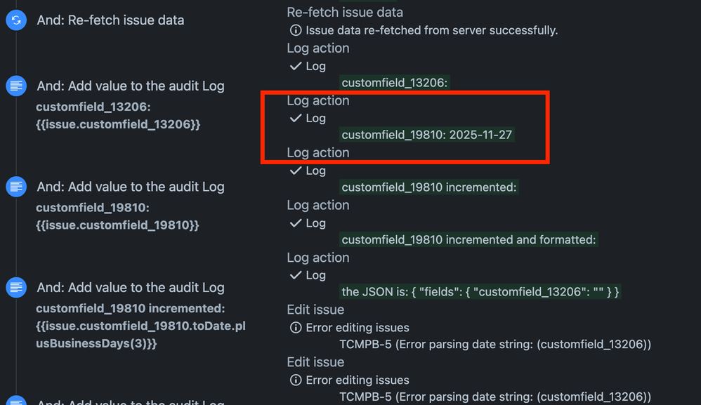

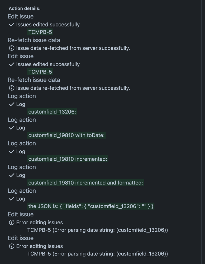

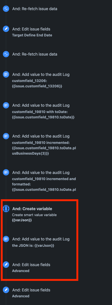

Shahriar
November 14, 2025

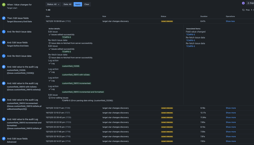

Hi @Bill Sheboy ,
I added the logs you instructed. I've never added logs to the rule before; this is the first time. I hope I did it correctly. Please let me know if I need to make any changes or corrections, and I'll resend. I added all the screenshots and images with the other information you requested. Please let me know if I've missed anything.
Thank you!
Thanks,
Shahriar
Screenshot 2025-11-14 at 10.44.34 AM.pngScreenshot 2025-11-14 at 10.46.21 AM.pngScreenshot 2025-11-14 at 10.26.13 AM.pngScreenshot 2025-11-14 at 10.26.38 AM.pngScreenshot 2025-11-14 at 10.28.20 AM.pngScreenshot 2025-11-14 at 10.28.35 AM.png
Bill Sheboy
November 14, 2025
Thanks for that testing, @Shahriar
Based on the log entries you see, either those are not the correct smart values for the fields or they are not supported by automation rules.
To check if the fields are supported in rules, please use this how-to article: https://confluence.atlassian.com/automation/find-the-smart-value-for-a-field-993924665.html

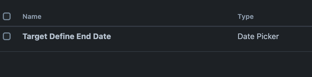

Shahriar
November 17, 2025
Hi @Bill Sheboy ,
Thank you again so much for looking into this for me.

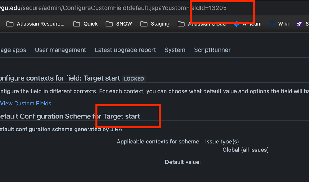

I am confused as to why those would be incorrect smart values. I will check the link you sent to see if those fields are supported or not by the automation rules. It would be disappointing if the automation rule doesn't support the field "Target end", as it allows me to use the "Target start" during the "When: Field value changed" rule at the beginning. Target end and Target start are the same type of field. It's somewhat silly that the "Target end" doesn't appear in the dropdown during the “Edit issue” rule.
I will provide some screenshots to illustrate my point.
That said, I will check the link you provided. I hope I will be able to find a workaround or something. Thank you again so much for all your help!
- Shahriar
Screenshot 2025-11-17 at 9.26.36 AM.pngScreenshot 2025-11-17 at 9.26.11 AM.png

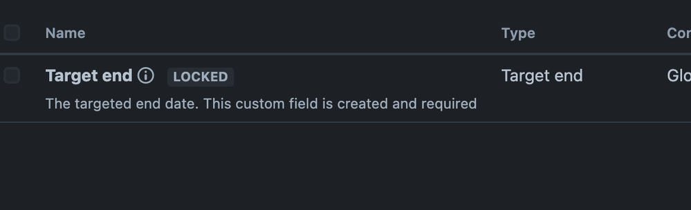

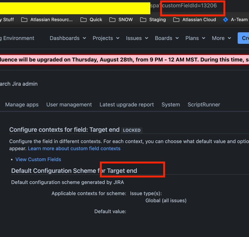

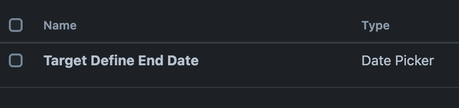

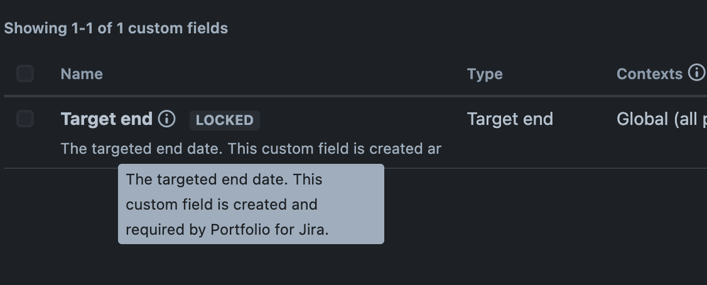

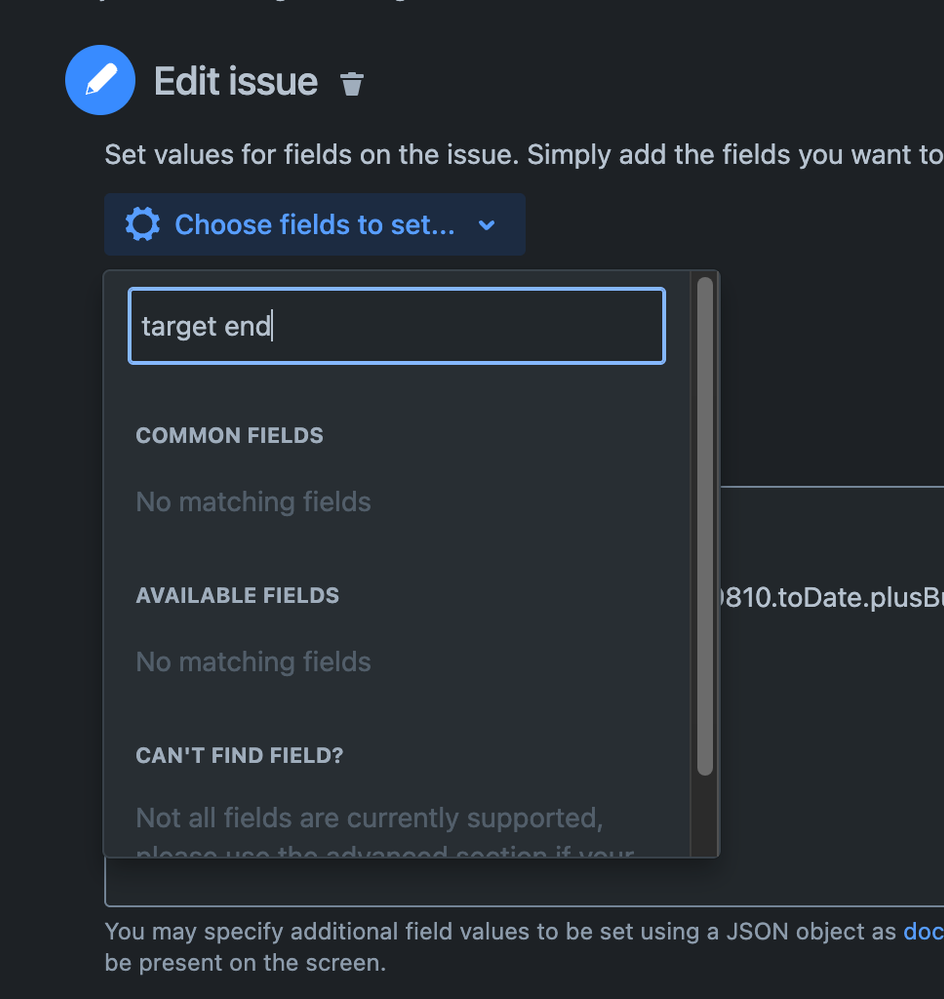

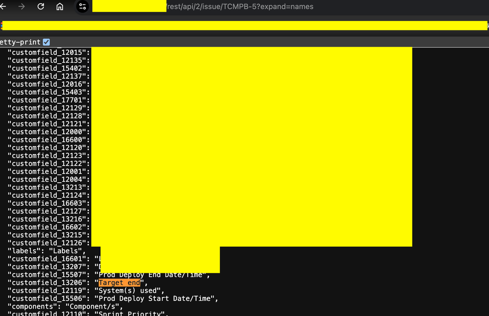

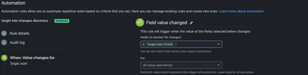

Shahriar
November 17, 2025
@Bill Sheboy ,
If I am looking at this correctly, the "Target end" field is supported by the automation rules. Screenshot added.

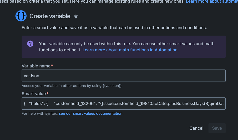

Bill Sheboy
November 17, 2025
Thanks for those additional checks, @Shahriar

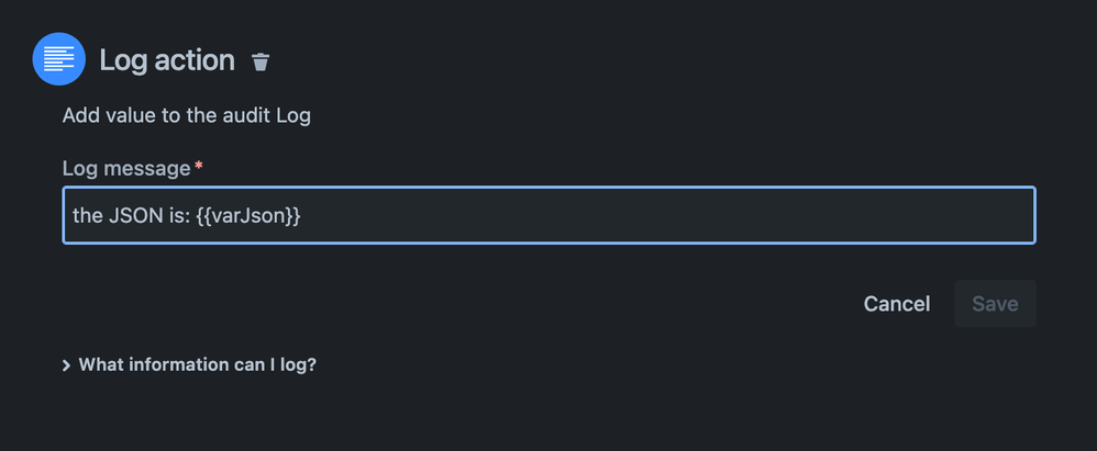

This could be a timing problem where the smart value expression is not evaluated fast enough for the Edit Issue fields action to use it.  The way to check that is using a Created Variable action to pre-build the JSON for use in the action:

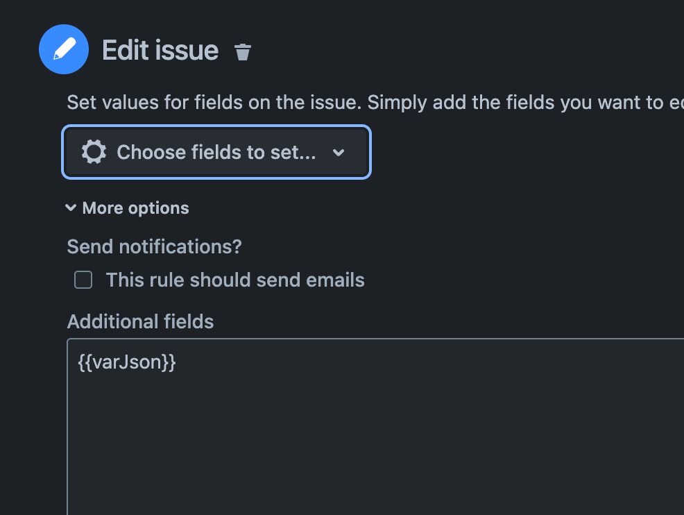

  • action: create variable
    • variable name: varJson
    • smart value
"fields": {
"customfield_13206": "{{issue.customfield_19810.toDate.plusBusinessDays(3).jiraDate}}"
  • action: log
the JSON is: {{varJson}}
  • action: edit issue, where the entire JSON expression is just the variable:
{{varJson}}
This approach will also allow you to check what JSON is being used in the action.
Shahriar
November 17, 2025
Hi @Bill Sheboy ,
I added what you mentioned. Could you please review my screenshots and confirm if this looks correct, and what I should do next?Screenshot 2025-11-17 at 10.50.05 AM.pngScreenshot 2025-11-17 at 10.54.51 AM.pngScreenshot 2025-11-17 at 10.55.11 AM.pngScreenshot 2025-11-17 at 10.55.35 AM.pngScreenshot 2025-11-17 at 10.55.47 AM.pngScreenshot 2025-11-17 at 10.57.23 AM.png
Bill Sheboy
November 17, 2025
Based on all of that, the field did not convert to a date or it was already a date.
Please change your log action for:
  • action: Log, with this expression...
customfield_19810 with toDate: {{issue.customfield_19810.toDate}}
Into this:
customfield_19810: {{issue.customfield_19810}}
This will confirm what the rule "sees" for the field value before any attempts to change it.
