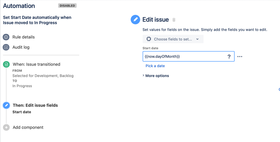

Was  trying to attach file unsuccessfully so will describe my rule setting:
Rule Set Start Date automatically when issue moved into status 'In Progress'
1. When issue transitioned
FROM Selected for Development , Backlog
TO
In progress
2. THEN
Edit issue fields
Start Date
{{now.dayOfMonth}}
I am not sure if Start Date is a right field to update in this case, same about end date. Should I update some other fields?
Yana Nikolayeva
June 16, 2020
Yana Nikolayeva
June 16, 2020
Finally was able to upload.
Please do not pay attention to  Rule tag ‘Disabled’ as after I did get any result I set it off.

What if you just used {{now()}

Thank you for advice John_Funk, unfortunately  {{now()}  does not work.
I will look into your suggestion Bill_Sheboy, thank you very much for details.
Bill Sheboy
June 17, 2020
I believe that is missing one brace at the end and has extra parenthesis.  Please try:
{{now}}

John Funk
June 17, 2020
Yes, sorry about the syntax error.
