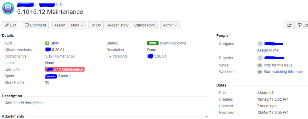

We want to move from HP AM to Jira but unfortunately this is not straightforward. First, because there is no CSV export usable from AM. So we decided to do it by hand i.e. recreating previous sprints, main stories, etc. As the result was not conclusive, we even tried exporting/re-importing stories, a few updates in the DB, etc.
Here is our current situation and our problems:

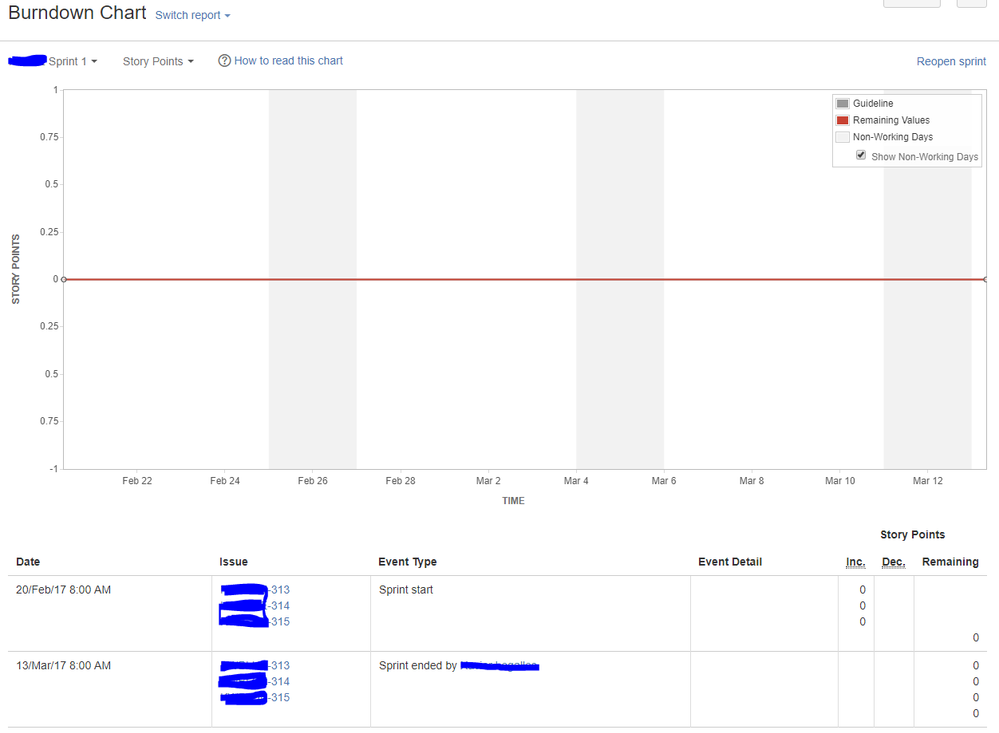

  • All burndowns are flat i.e. 0 story points

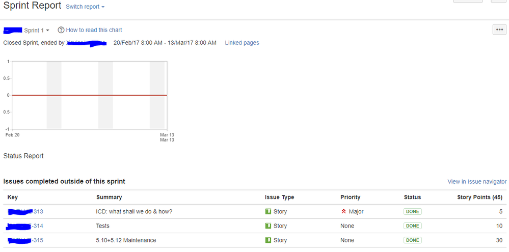

  • All sprint reports are flat (i.e. 0 story points) while the list of stories is good and the total story points displayed per sprint is also good

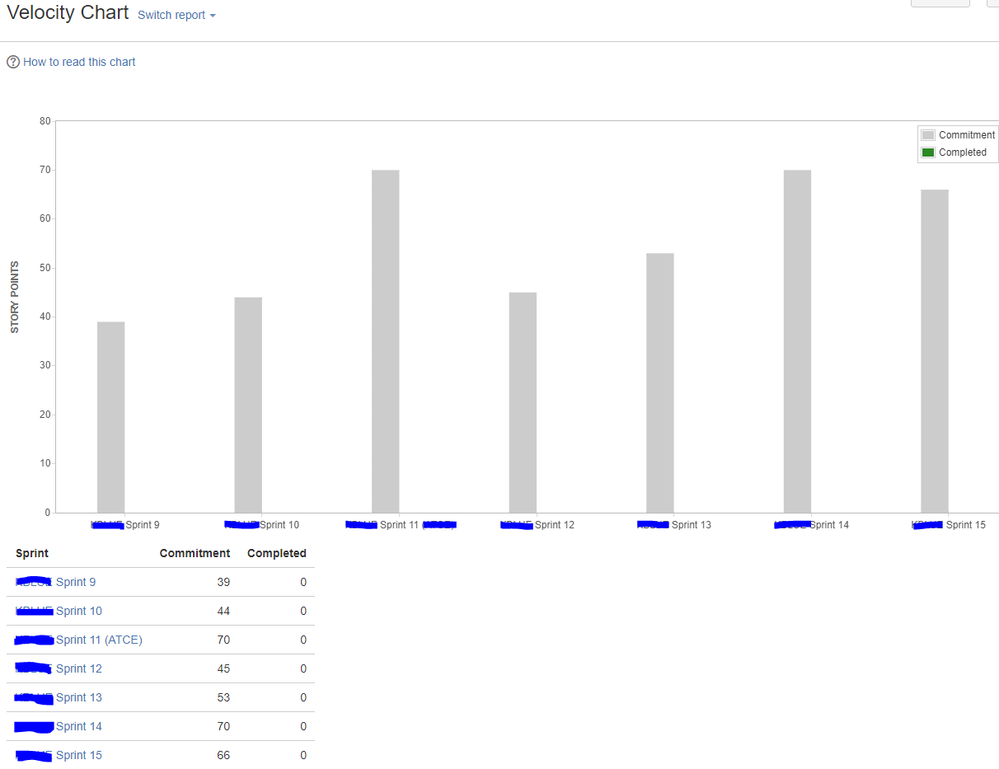

  • The velocity report does not show any completed points but commitments are good

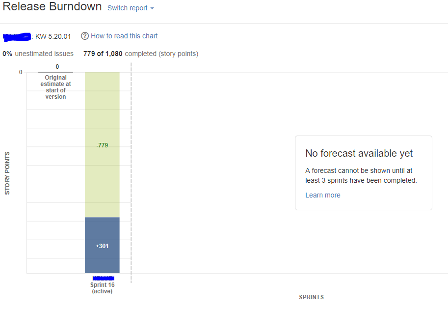

  • The release burndown stacks all story points into the current active sprint and cannot display any forecast because "it needs at least 3 completed sprints"
I've seen a lot of threads related to one or another of these problems, so let me add a few remarks:
  • All sprints have correct start/closed dates
  • All stories have a status done which is well defined in the right column of the workflow.
  • All stories have a created date < start date of the sprint and a resolved date < closed date of the sprint
So yes, it's a real mess! But we don't see anymore solution to our problems. Is there any documentation on how to start a project with an existing history? Is there any way to solve our problems (even by updating the db)?

Thank you for your answer but we already tried it and did not have much success. For instance, all dates for sprints are right but stories are not taken into account: the list of stories per sprint is also right but it does cumulate their story points...
