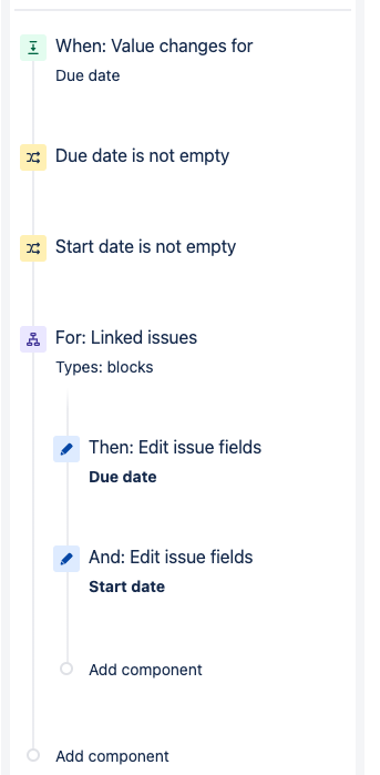

Here's what I have so far:
But I'm not sure about the smart values and I'm also not sure if I should have the Start and Due Dates in one automation or separate them out. Can anyone help?

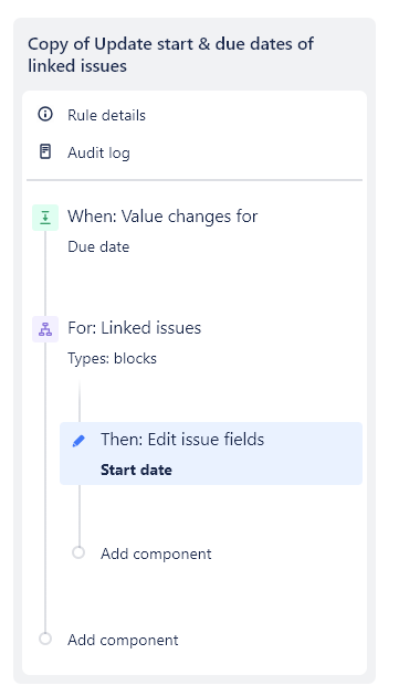

I have a similar case and tried your rule (adjusted to my case) but got a blank result of the calculation. The rule literally deleted the Start Date of the blocked issue after I edited the End Date of the blocking issue. Do you know what might be the cause of it?
My formula for updating the Start Date of the blocked issue based on the change of the Due Date of the blocking issue is:
{{issue.Start Date.plusDays (triggerIssue.fieldChange.from.toDate.diff(triggerIssue.fieldChange.to.toDate).days)}}
And here's a screenshot of the rule:
Trudy Claspill
November 29, 2023
Hello @Yordan Yordanov
Since the original author of this Question has already accepted the answer, please start a new Question of your own to get help with your scenario. Starting a new Question will also make your request visible to more of the community. When you add to an existing Question the only people who will see that are the original author, anybody who has already responded, and anybody who is Watching the Question.
In you new Question include a link to this original Question to help community members understand your starting point.
Please also include the output for the rule execution from the Audit Log.
I also advice you to make liberal use of the Log Action in your rule to print the actual values of your fields and each smart value you are trying to use to validate that they contain the values you expect.

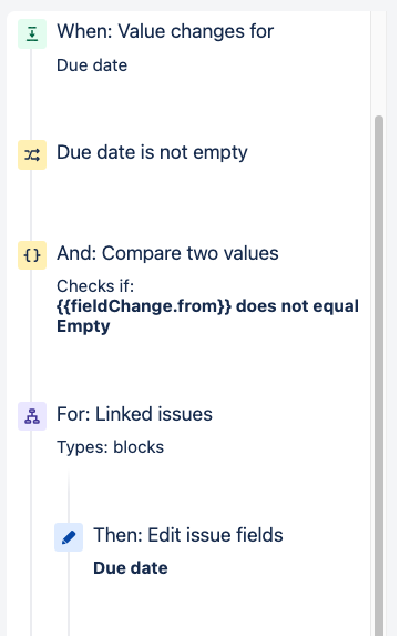

Jespir Ragbotra
June 22, 2023
Thank you! I changed it so that I'm only using the due date based on your point above. Here's what I got:
For Due Date, I put in:
{{issue.duedate.plusDays (fieldChange.from.toDate.diff(fieldChange.to.toDate).days)}}
And that worked!
