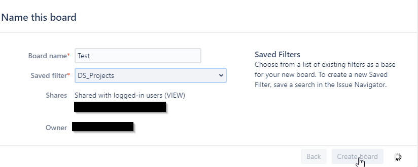

Hi @John Funk ,
I don't get an error, as you can see in the screenshot I provided at the comment from @Fabio Racobaldo _Catworkx_.
Yes, I try to create the board on an existing filter via:
  1. Boards
  2. View all Boards
  3. Create Board
  4. Create a Kanban Board
  5. Board from an existing Saved Filter
  6. Name this board
  7. "Error" -> See Screenshot below

Chris K
May 24, 2023
Hi @Fabio Racobaldo _Catworkx_,
Thank you for the hint. I made sure, that the filter is shared. When I try to create the board, I get a loading Icon (a view milliseconds) as you can see in the screenshot. After that, nothing happens, and I am able to push the button “Create board” again. Kanban Board.png
