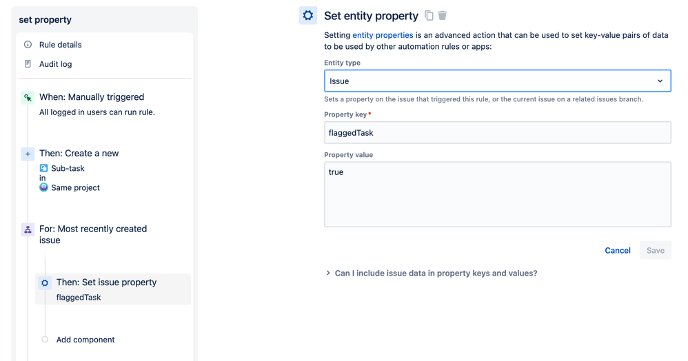

There is an action you can run inside of automation for Jira called "set entity property".
After you create the subtask you want to trigger the email, do a branching on the most recently created issue and set the entity property your subtask.

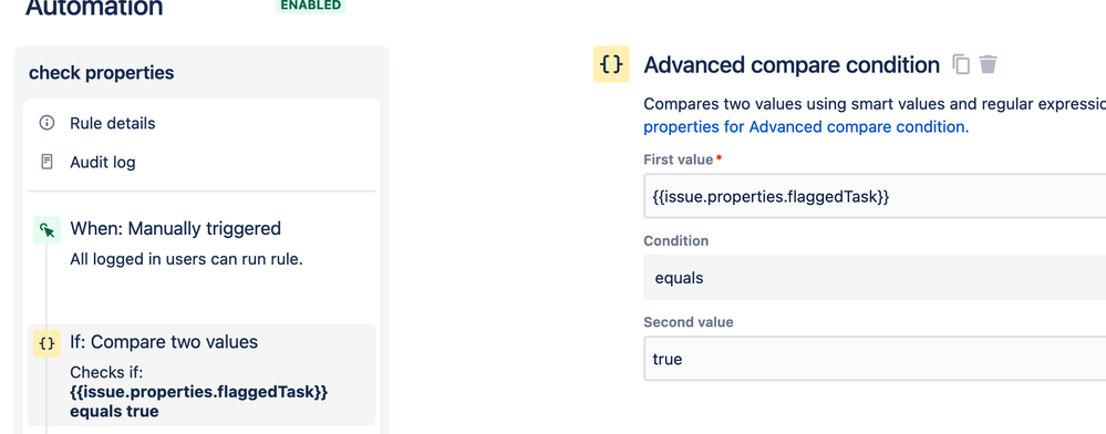

Then, in the rule you want to send the email, you can check for the entity property.
