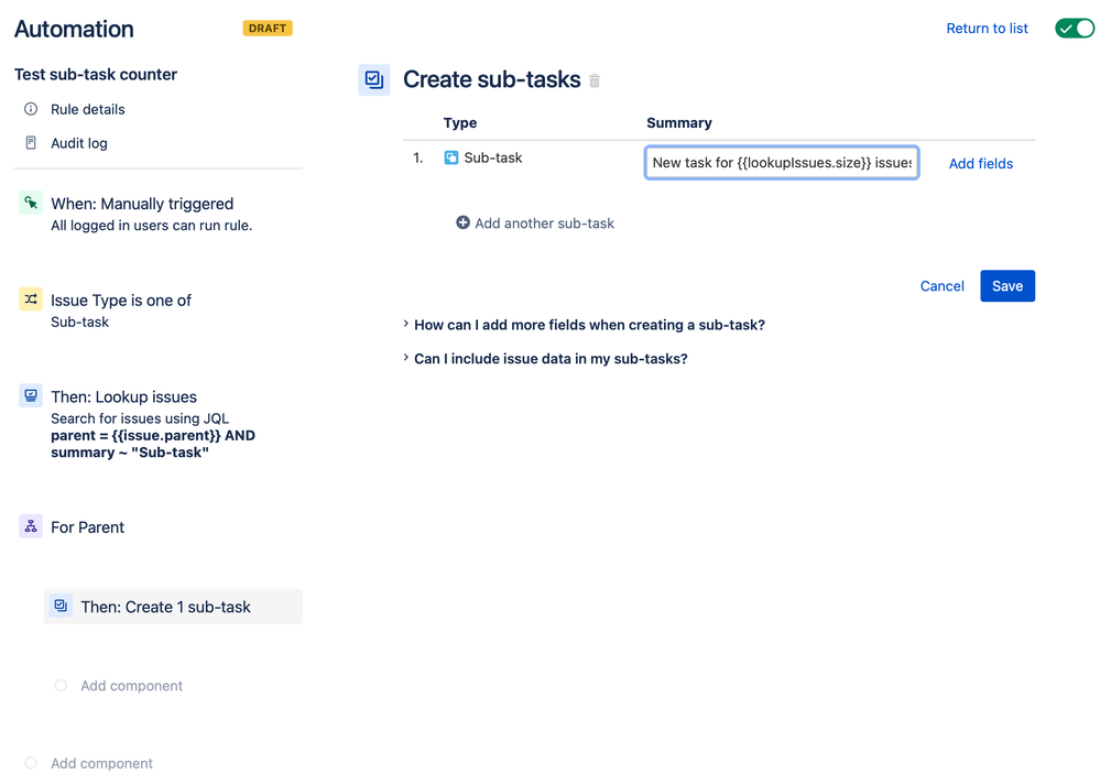

I have 3 subtasks (each a different issue type - one of each issue type is in each story), and a 4th issue type of subtasks get added in various quantities on each story.
So let's say, upon transition of subtask issue type #2, I need issue #3 to be created with something showing the sum of all #4 issues within the same story.
  • subtask issue type #1 - typically 1 for every story
  • subtask issue type #2 - typically 1 for every story
  • subtask issue type #3 - typically 1 for every story
  • subtask issue type #4 - QTYs vary for each story
Preferrably this number would be in the summary after the standard name, but if i have to make a custom number field, that would be fine too.
Alternatively, this could count the number of issues in Ready status versus count of the issue type, since up to this transition, the previous 3 subtasks would be closed.
*Notes:  I've already got #3 creation automation running upon closing #2--just looking for how to update automation to get the sum as described.  Also, looking for solutions without scriptrunner or other plugins please.

You can do that quite easily using automation in Jira Cloud, by using the Lookup issues action.
The following screenshot shows an example rule which you can run manually against a sub-task.
The {{lookupIssues}} smart value returned by the action is a list and therefore you can run any of the list functions against it; in this case I'm using .size() to count the number items in the list.
Mo
January 19, 2021
@Gareth Cantrell thank you so much!! This worked perfectly!!!
