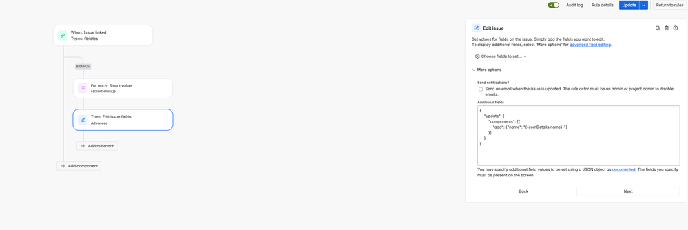

You already did the conditions; additional you may need to do as below:
- Advanced Branching as"{{destinationIssue.components}}"  and variable name as 'comDetails'
- Edit issue and add below in additional fields:
"update": {
"components": [{
"add": {"name": "{{comDetails.name}}"}
In above, we are adding components to the exists, not overwriting them !
Note: Rule executes when an issue is linked to another issue. {{issue}} will always refer to the source issue, so if ISSUE-A is blocked by ISSUE-B, this rule will execute on ISSUE-B. To access ISSUE-A, use {{destinationIssue}}, and to access the link type, use {{linkType}} (e.g. {{linkType}}
