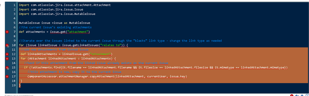

Swarna Radha
August 20, 2019
Hi,
I am getting errors in the script as from for (Issue linkedIssue : issue.getLinkedIssues("blocks")) { till the end of the code
import com.atlassian.jira.issue.attachment.Attachment
//the current issue's existing attachments
def attachments = issue.get("attachment")
//iterate over the issues linked to the current issue through the "blocks" link type - change the link type as needed
//add new attachments from linked issue
def linkedAttachments = linkedIssue.get("attachment")
for (Attachment linkedAttachment : linkedAttachments) {
//test if this attachment from the linked issue already exists on the current issue
if (!attachments.find{it.filename == linkedAttachment.filename && it.filesize == linkedAttachment.filesize && it.mimetype == linkedAttachment.mimetype})
//this attachment is new, copy it to the current issue
ComponentAccessor.attachmentManager.copyAttachment(linkedAttachment, currentUser, issue.key)
David Fischer
August 21, 2019
Hi,
The code I shared is for JMWE, not ScriptRunner. That is why it is failing in ScriptRunner.
Regards
David
Swarna Radha
August 21, 2019
Hi,
Is there any code for script runner?
Thanks,
