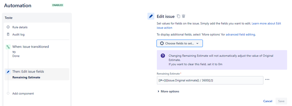

I want to copy the Original Estimate field into the Remaining Estimate field.
I made an automation like this: {{Original estimate}}.
But it was returning an extremely big number.
So, a changed to {{#=}}{{Original estimate}} / 3600{{/}}, and it broke.
Now, I made as the picture below, but it's not working.

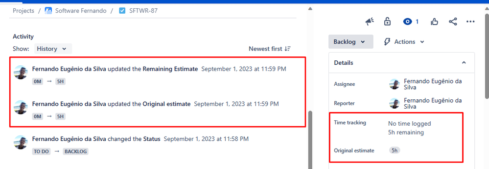

Generally the field Remaining Estimate start with Original Estimate value. Remaining Estimate makes part of Time Tracking field. So, when you set 5h to Original Estimate your Remaining Estimate field is automatically filled with the same value until you make some log in your issue.
Considering this, I didn't understood your the concept behind your automation rule. If you would give more details, maybe we can find some solution together.
