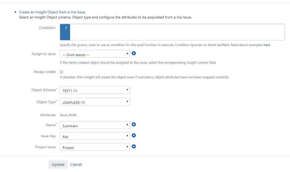

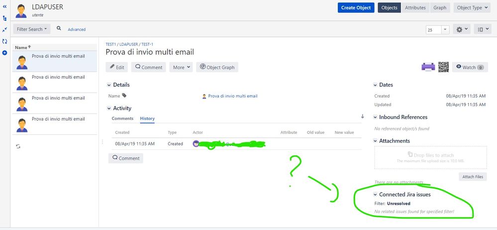

hi guys i want connect issue in the object riada when it is create.
do you have any idea to how can i do?

     Looking in your screenshots - it seems that your Object is being created in an Insight Postfunction.
In this case, please see in your Postfunction Configuration screenshot, the option: "Assign to Issue".
Here you indicate if the newly created Object should be set as Value in which Insight CF on the Issue.
In your case, it is configured as "Don't Assign", however, if you select an Insight CF here, which is available and visible on the Jira Issue - the New Object will be set in this CF (as long as the CF Configuration IQLs allow it!), and you will see the Jira Issue in the "Connected Jira Issues" Panel.
If an Issue is created in any other way, and given that you know the Issue you wish to assign the Object to -  than you can configure an Automation rule, to fire a Jira REST API to set the Object as a Value in an Insight CF...
