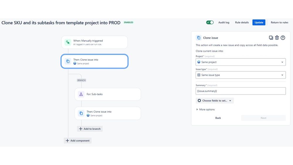

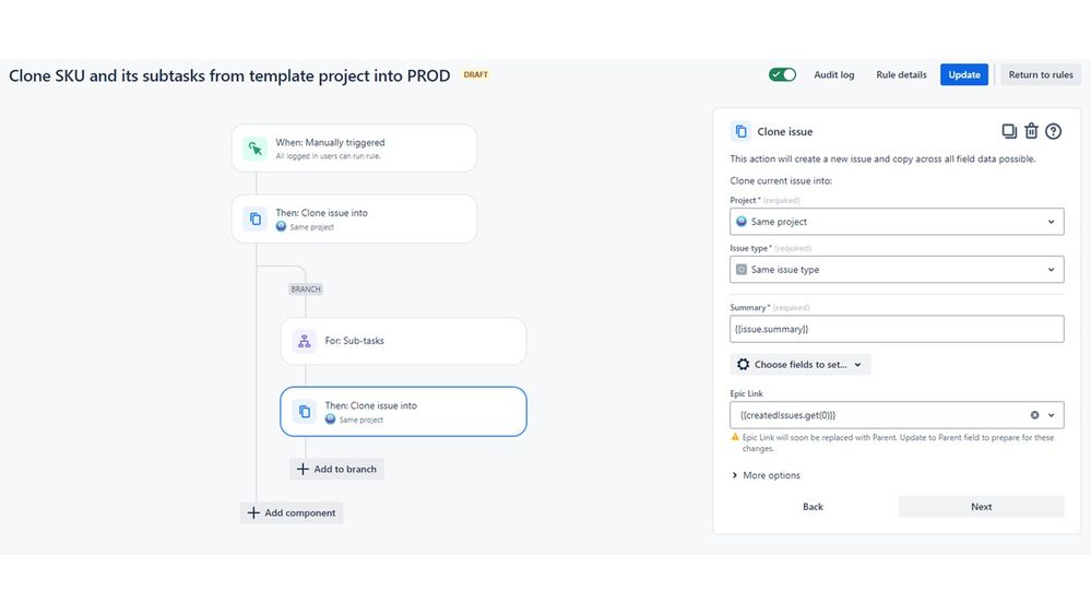

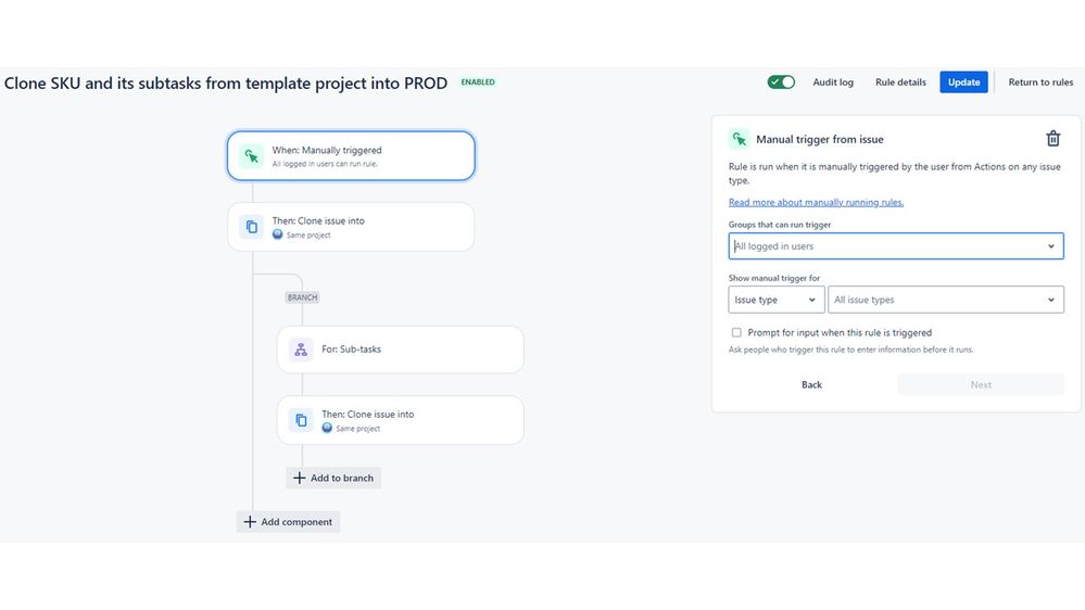

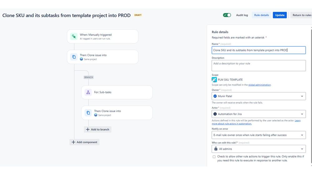

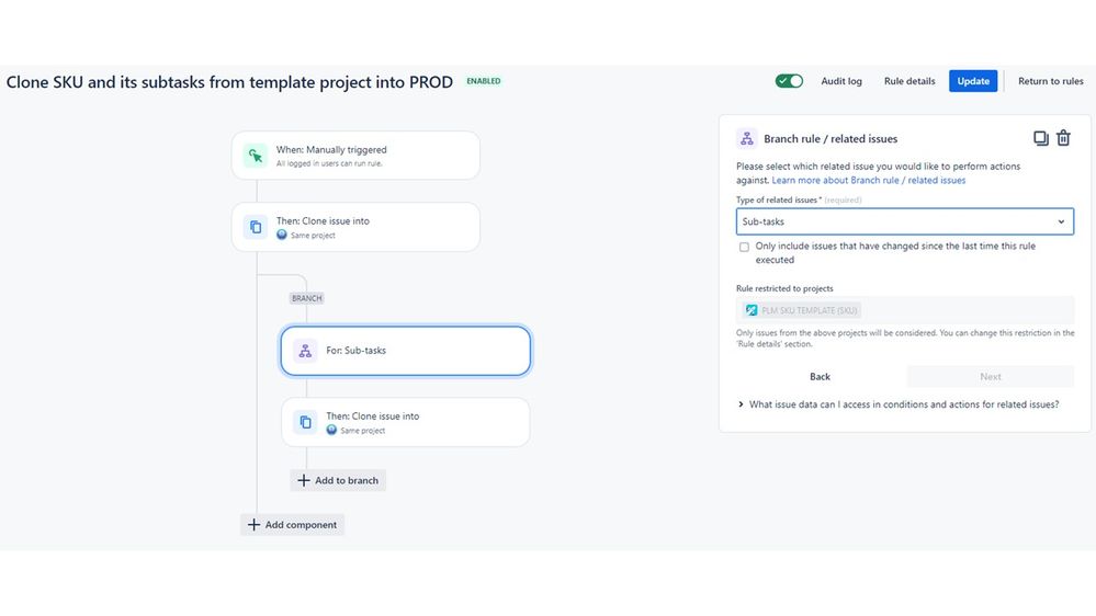

Hello @Munir Patel
With the For Each option I don't believe it is possible to dictate the order in which the sub-tasks are cloned and added to the previously created issue.
I think that you could instead use a Lookup Issues action to retrieve a sorted list of the sub-tasks of the original issue, and then use a branch to step through that sorted list to clone the sub-tasks in order. I have not actually tried that yet. There is a discussion of using a For Each branch to iterate over the results of a Lookup Issues action in this post:
https://community.atlassian.com/t5/Jira-questions/Use-lookupissues-to-then-clone-those-issues-and-their-sub-tasks/qaq-p/2263298
