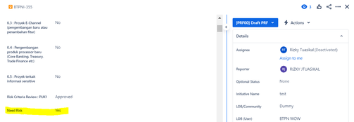

previously there was a field, named Need Risk, with a value of YES.
(Need Risk = YES)

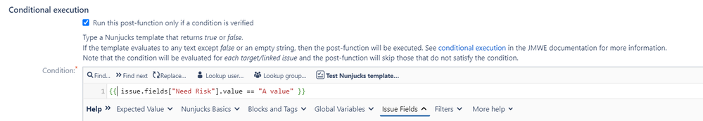

but I don't know what the correct query is, for the Conditional Execution part.

Hi @RIZKY JTUASIKAL,
You can use the below Nunjucks script that returns true when the value of the field is "Yes"
{{ issue.fields.customfield_11000.value == "Yes" }}
Replace 11000 with the ID of "Need Risk"
If the "Need Risk" field is on the transition screen and you want to check in the post-function if the value of this field has changed on the transition screen, then you can add the below Nunjucks script in the Conditional Execution of JMWE Transition issue(s) post-function, that returns true if the value of the field was changed on the transition screen:
{{ context.changelog.fields["customfield_11000"] }}
Replace 11000 with the ID of "Need Risk" field. If you want to use the above script, then the JMWE Transition issue(s) post-function must be placed after the “Update change history for an issue and store the issue in the database” built-in post-function.
I hope this helps!

the Need Risk field is not on the transition screen.
Let's just say, before submitting the status from Draft PRF to Risk Pre-Assessment status, the Need Risk field already has a value of YES
Then, how is the query? Is there a solution for this? :(
if the Need Risk field, already has a value of YES, and is not on the transition screen
