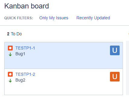

Then user started to complain in the new ( main ) Jira instance's agile board, if a issue is unassigned, it's showing as "U". They feel it's confusing since a user name started with "U" will also be showing as "U" ( although in different color).

<div class="ghx-avatar"><span class="ghx-avatar-img" style="background-color: #ea632b; " data-tooltip="Assignee: Unassigned">U</span></div>

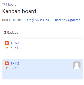

I just fresh installed a 7.13 instance without any data , and its Kanban looks like this:
Unassigned user doesn't have avatar and assigned user shows a gray icon when he doesn't have personal avatar.

OK I think I figured out half of the puzzle. there is a "gavatar" system configuration. On fresh installed Jira 7.13, it's setup as "ON". Then jira shows the icon/empty image. If I switch it to "Off", Jira shows user Iniatial and for unassigned user, it shows empty.

OK figured out the other half. It looks like our primary Jira is treating unassigned user as a regular user. I searched user directory and find a local disabled user with username "unassigned", full name "Unassigned".
I changed its full name to " Unassigned", the "U" is gone. Not sure why it's setup this way, but it's what it is.

The issue is when a issue is really unassigned ( in database jiraissue's assignee value is '') , in Agile board Jira tried to find a user with app_user.user_key = 'unassigned' , then it found the disabled user and showed  that user's avatar.
