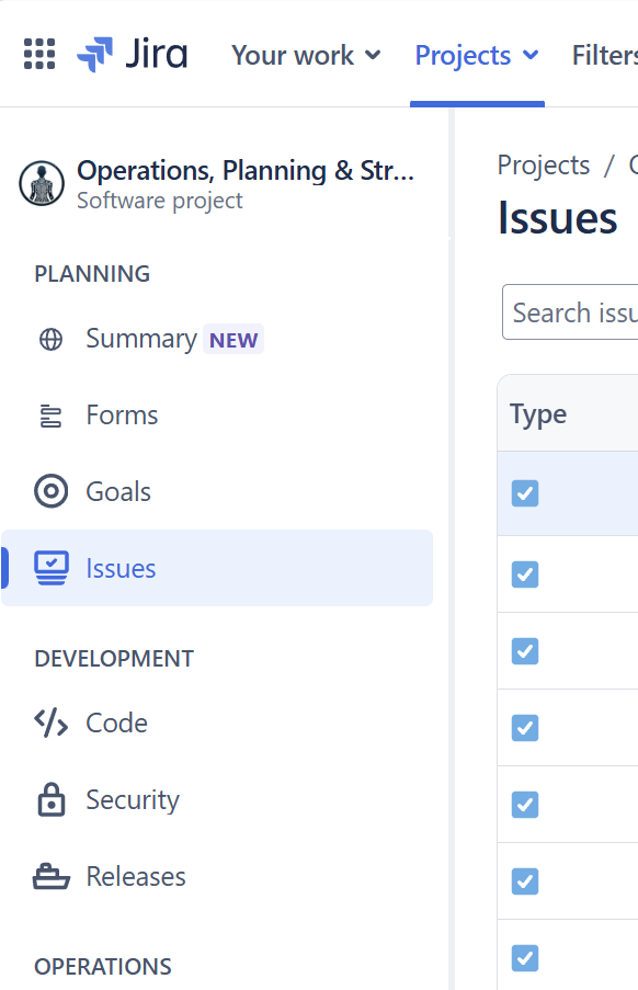

Hi @Mathew Lederman , thanks also for your quick answer. Great idea with the screenshot. So I have several different "problems" with different views, but the most important for now is in the picture below. For 2 of my software projects I can only see "goals" and "issues" and some other views, but no "timeline" for example. There is no possibility to add the "timeline" view anywhere. For other projects I have a total different "PLANNING" view, that is not focused on the "issues" so much. Do you have any idea how to change that? Is it possibly a setting of my colleagues to change my "admin rights" or similar to the project? If so, would you be able to say how? Thanks so much in advance!Screenshot 2025-01-14 090100.png

@Franziska Mieland I believe what you're looking for can be found under Project Settings > Features. It sounds like these items are simply disabled for the project. If you cannot turn on the Timeline feature, it will likely give you an error of "To enable or disable the timeline for a board, visit your board settings."  For this, go to one of your projects' boards, then click the three dots in the upper right then Configure Board. At the bottom of the menu on the left should be 'Timeline' which should have a simple 'Enable Timeline' toggle.

Hi @Tomislav Tobijas , thank you so much for taking the time to answer me. I'm not an agent and do not use Jira Service Management as far as I see. Also, I am quite sure I've got the same product as the others. Different is only the overall starting page and the views. So what I found out for example, is that I cannot see the "timeline" and "list" in some of the software projects. I on the contrary see "goals", which goes hand in hand with the issue that I only see "issues", and not the whole project. For other software projects that I created I have the option of choosing several different views like forms, timeline, backlog and no "goals". We tried to see differences in the settings with other colleagues, but couldn't find any so far.

'Interesting' issue. I would suggest checking what @Mathew Lederman said - Project settings > Features to see if those features are enabled/disabled. However, this configuration is on project-level so it would affect everyone.
As for Goals and Atlassian Home, the site you're using might be rolled in new Platform Experiences so this might have made a difference in the UI.
I would suggest reaching out to Atlassian Support as they would be able to access your site and log in as specific users to debug the problem furthermore.
