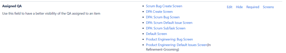

You can see in this screen-shot on the Field Configuration screen, that the word 'Required' doesn't show next to the field.

This optional button was deleted with an update? I'm Jira admin and I don't have it. Thank you!
Rudi Wagner
December 10, 2023
It is the "Required" on the right. If you click it it will change to "Optional". So right now the field is optional.

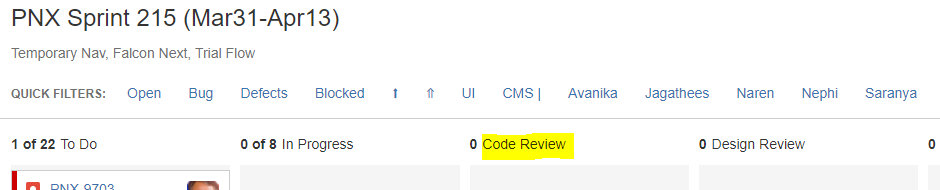

Thank you for your responses. I was assigned to help with Jira but I am pretty new and was not involved with all the workflows and everything set up. So trying to understand how it works to help accommodate some changes.  I went and took a look at the workflows but I am a bit nervous to make any changes that will impact.
So for example, here is something I am trying to do.  In a card where the issue type equals to Non Technical the Code Review field should not be present or required and the card should go from In Progress to Design Review in the board. Basically it should not be allowed to be added to the Code Review step (see image above).  Is this possible?  Can I hide a field or not make it required base on a issue type?

The board (from your screenshot) is basically just a visual representation. To make an Issue skip a status you need to change the workflow. With "Workflow schemes" it is possible to assign different workflows to different issue types.
Rudi Wagner
April 5, 2022
It is also possible to set certain fields as mandatory on a transition in the workflow. Maybe check if there are validations configured on your transitions in the workflow. (Also creation is a transition in the workflow that could have validations configured)
