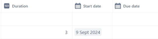

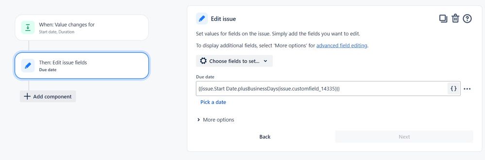

Here's a screenshot of the values on the Duration and Start date and the automation Edit part. I use "Duration" and the custom field ID and both options give me the same result.

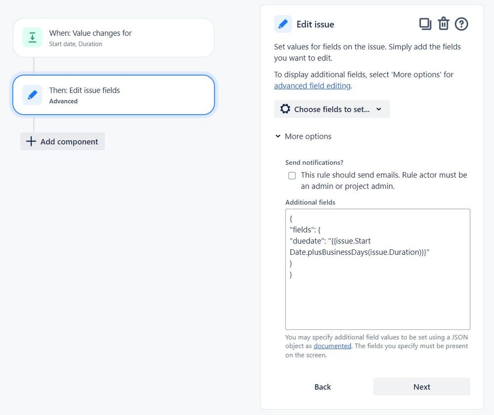

when i use the custom field id i am facing this issue but when i am using the name its working as expected so can you try one more time with the custom field name and still if its not working then can you try in the advance way. unselect the due date from the choose fields to set and click on more options and inside the additional fields insert this
"fields": {
"duedate": "{{issue.Start Date.plusBusinessDays(issue.Duration)}}"
and update the rule and see whether its working
Thank you.

Hi again @Jerrold - Empyra
First of all, thanks for your help.

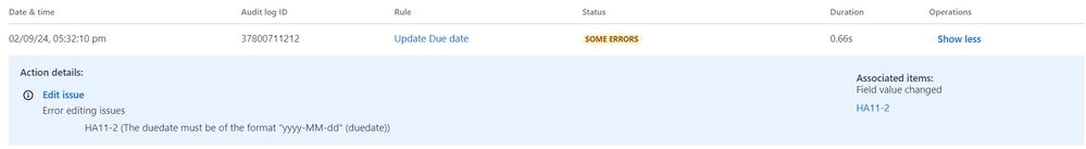

I made the changes you suggested and now I am getting the following error message:
And here's my rule:
I modified your query to see if that helped but I am getting the same error message:
{ "fields": {
     "duedate": "{{issue.Start Date.plusBusinessDays(issue.Duration).format("yyyy-MM-dd")}}"

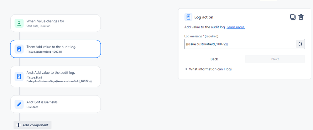

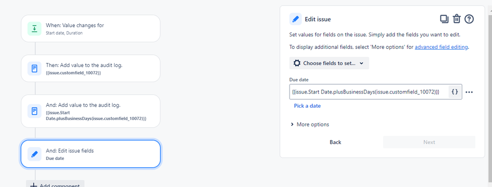

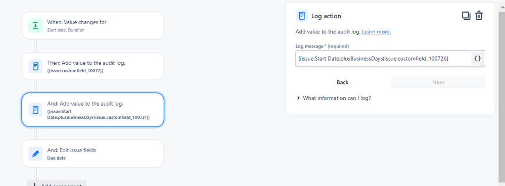

Can you Please try the below automation and share the audit logs. And Please make sure the "Duration" custom field ID is correct.
Thank you.

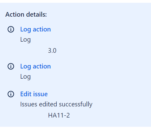

@Jerrold - Empyra  Same problem. The dueDate field gets empty and the Automation Audit Log shows no error:

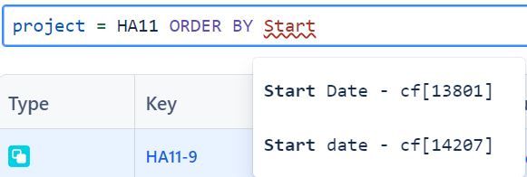

I'm sorry that I couldn't pinpoint the exact root cause of the issue. It seems like there might be an error in pulling the start date data, leading to a null value when adding 3 days to it. Please check if there are any other custom fields named "start date." If you're using the default start date, try replacing it with its custom field ID, which is "10015" (this ID remains consistent across all cloud instances). You can use the following smart value in the edit action:
{{issue.customfield_10015.plusBusinessDays(issue.customfield_14335)}}

I found the problem. The ID for my "Start date" field is 14207.
I used that on the Automation Script and it worked.
