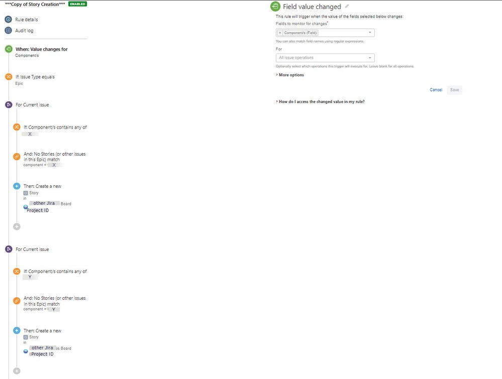

Hello,
I am able to create stories through automation whenever a component is added for the epic for all the different teams we have. However, my trigger is set to - "when issue is updated," so basically - yes, stories are created, but if anything else is updated on the epic - it will also create a story too. Therefore, giving me duplicate stories - because in a sense the issue is being updated per the trigger rule.
I have tried changing my trigger to "When value changes for component" but that is giving me duplicates stories every time I add a new component or even delete a component.
How can I change my trigger from 'when issue is updated' to 'when value changes for component' with out getting duplicates every time the component field is either updated or a value there is deleted? Please see my rule below:

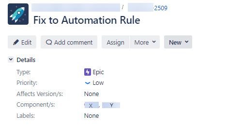

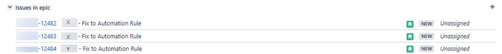

Issue is when I add another component to the epic and there is already an existing component - it will then create a duplicate story of the existing component that is already there (component and summary) and then create the story for the newly entered component. This is what I am seeing:

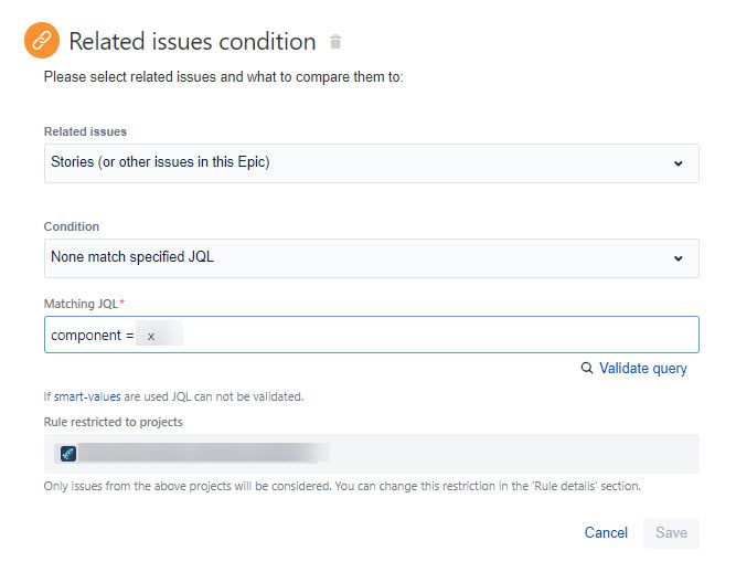

This is my JQL restriction that I have at a branch level  to avoid getting duplicates.

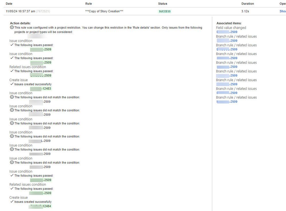

Audit Log, stories are to be created on a different project, so epic lives in another project and stories are created in another - works fine there too, but here are the audit log details:

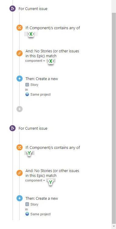

Rule:

You note Epic and child issues are in different projects.  In your rule details, is this rule for a single-project or multiple-project scope?
A single-project scope rule can only access issues in that project.  Please change the project scope to include all of the relevant projects and then re-test the rule.  Global or multiple-project scope rules are managed from the global admin area, so please work with your Jira Site Admin to make that change.

You are correct. As soon as I kept everything under one single project the rule worked as expected. At the moment I will keep things under one project, will reach out to my Jira global admins if ever we do have a strong need to include this rule to other projects. Appreciate your help on this one too.
