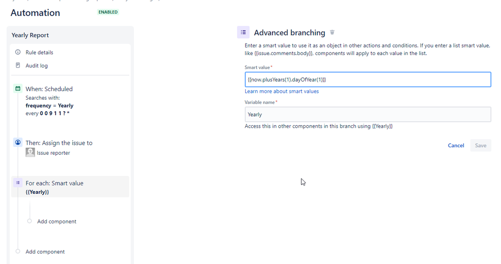

I ran this task to test it out, and it failed. Attached is a screenshot with my current automation - do you think there is something incorrectly set up on my end? You'll see I have the smart value entered in the "Advanced branching" condition.
I am trying to schedule this to have a due date on the first of every year, and I want this to be also run on the first of every year. I want to do this for my monthly and weekly reports as well, but I figured if I can get the yearly one set up then I can figure out the other ones.

Bill Sheboy
February 14, 2023
Hi!
My understanding was you were trying to set the Due Date for specific time frames, and so...there should not be a need for an advanced branch in the rule.
  • If you want the rule to trigger on that date/timeframe, set the scheduled rule schedule using the selections or a CRON expression, and then create the issue and set the Due Date.  As {{now}} will match your date, setting the field is straightforward.
  • If instead want to run the rule at any timeframe, and then create the issues and set the date for the desired value using a smart value expression.  Please look at the example expression I provided for the first of the year.
So the question is: when/under what conditions do you want to create these issues and set the Due Date?

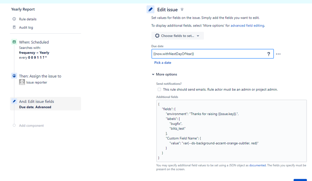

Mary Kasinger
February 28, 2023

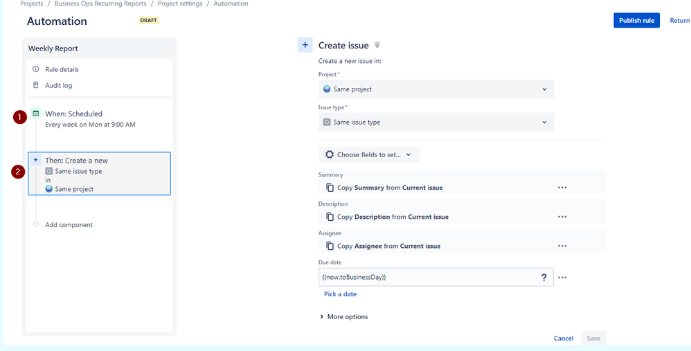

Thanks, Bill! I was able to create and run the automation to set up the correct due date. I'm now having trouble with duplication of these issues (see below screenshot of scheduled issue followed by the setup behind the action).Jira Automation.png

Mary Kasinger
February 28, 2023
HI Bill,

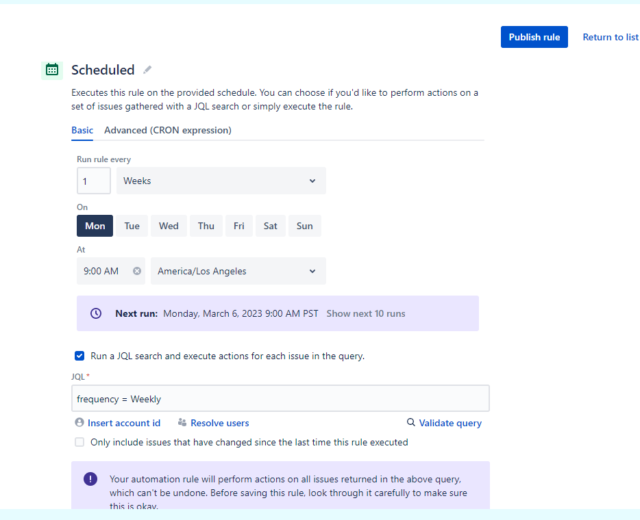

Yes, I have a JQL in the scheduled section of the automation rule that is scheduling a weekly run every Monday for every issue in the search that has a frequency = "weekly" (see below screenshot of the first part of the automation I didn't include previously). I hope this is what you need, if not let me know! Thanks so much.
Bill Sheboy
February 28, 2023
Thanks, and that helps.
The JQL for that trigger will return *all issues* which have frequency = Weekly.  As you are running this rule once a week, the number of issues it finds will increase by one each week.

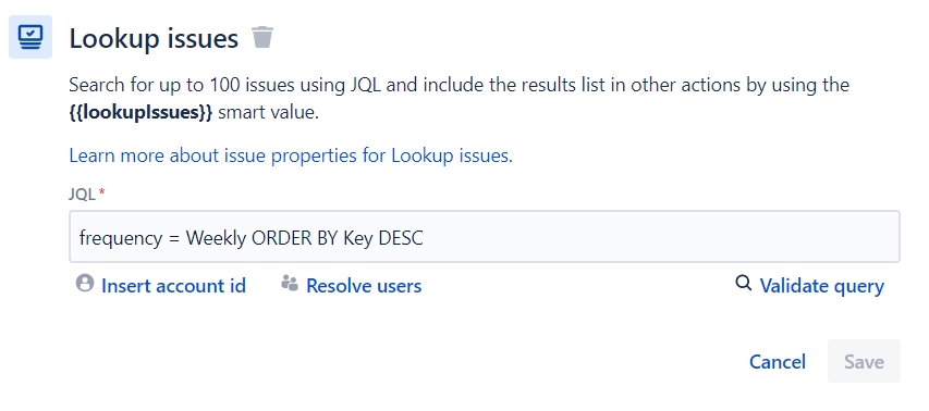

The Lookup Issues action accepts your JQL and then returns a set of issues, like this:
You may then access the fields of the returned issues to create your new issue, as shown below.  I recommend specifically selecting your project and issue type using this approach.

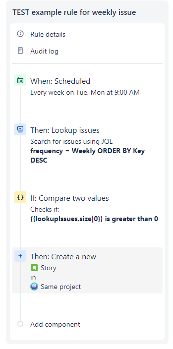

The complete rule would look like the one below, including an Advanced Compare Condition to handle the case of no existing issues found.

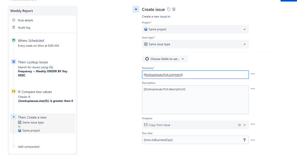

Mary Kasinger
March 28, 2023
Hi Bill,
Thanks for the detailed response. I am able to grasp and setup these steps based on your screenshot, but I am still not grasping the "create issue" portion. Do I need to define any the fields in my current issues further? here is my screenshot of what I have set up now.recurring automation rule.png
Bill Sheboy
March 28, 2023
Smart values are name, spacing, and case-sensitive...including the built-in ones.
And I noticed you have the case incorrect for the lookup ones, which would return empty values.  Please try following this template, noting that lookup is lowercase and Issues is uppercase:
{{lookupIssues.first.summary}}

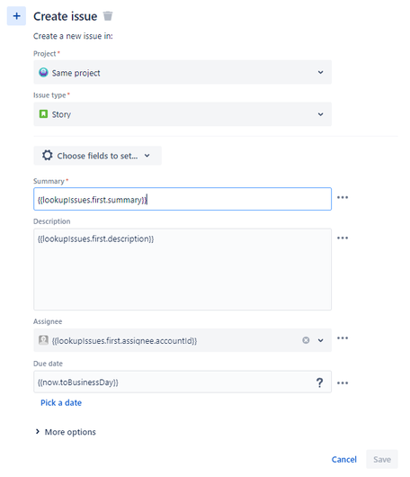

Mary Kasinger
March 28, 2023
Good to know, thank you. I've updated the smart value case.

Mary Kasinger
March 28, 2023

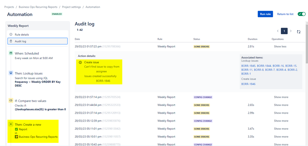

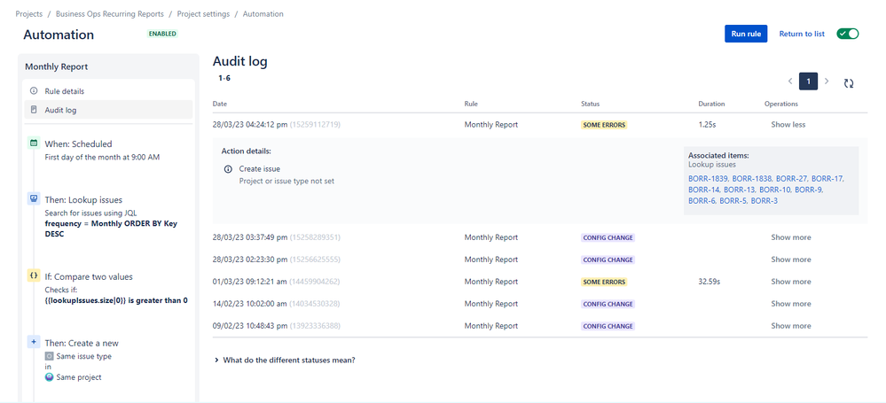

Ah, I will look at this log moving forward. I am getting some errors (see below). Not sure what the error "project or issue type not set", but no new issues have been created. I did run it just now, apparently it didn't run the first time. Still no new issues.
Bill Sheboy
March 28, 2023
Yup...there are no issues from the trigger...from which to copy the project or type.
In your issue create, if you select the project and issue type from the dropdowns the error will be fixed.
Mary Kasinger
March 29, 2023
Oh, I see.  Now, I chose the project and issue type from the dropdowns and ran the rule with some errors. It cannot find the assignee. I tried 3 different ones - copy from issue, parent, and trigger issue.recurringauditlogerror.png
Bill Sheboy
March 29, 2023
Progress!  Okay, for the assignee you can use the same technique with lookup issues, if you want the same person assigned:
{{lookupIssues.first.assignee.accountId}}

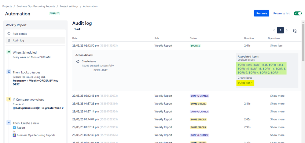

It was a success in the audit log, but it only created one of the weekly issues instead of the other ones in the lookup array (if that makes sense) see below screenshot. And thank you!recurringauditloglookup.png
Bill Sheboy
March 29, 2023
Mary, I think I missed something from the beginning of your scenario...I thought you were adding a single weekly issue, for each week.
Do you instead want to add several different issues, which re-occur for each week?
