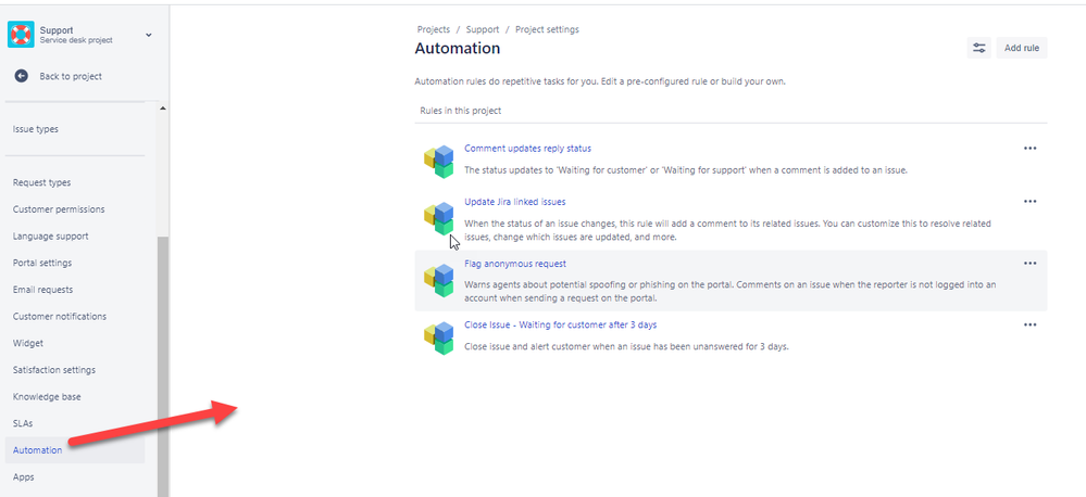

Also, you can set automatic closing of issues after some time period
Regards
