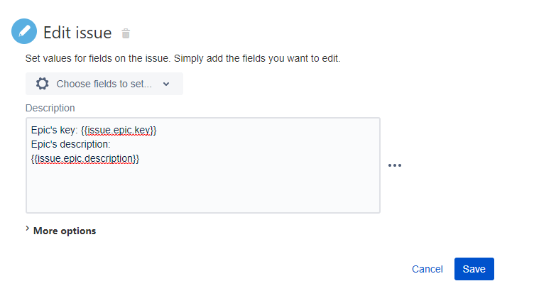

Originally, I wanted to append the description(but it seems that I'm only allowed to set it).
1. I've tried setting the description's issue via the Edit issue action, but the issue's epic fields are empty/null.

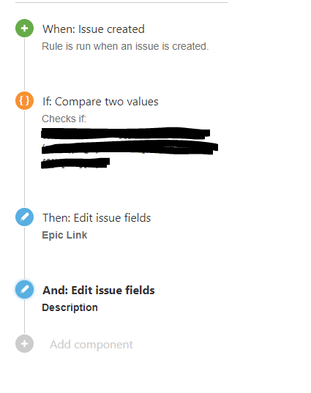

The flow of the rule looks something like this:

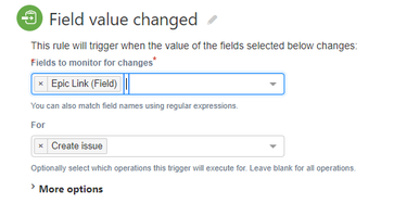

2. Then, since the description was updated, but with epic's fields empty I thought it executed the action without having the epic field populated. So I tried adding a second rule that would be triggered when the epic's link is changed with the same condition as the first one.
However, this one didn't even trigger, can't understand why. I guess I chose the wrong trigger:
Edit: Also added the edited issue option, but it didn't help.

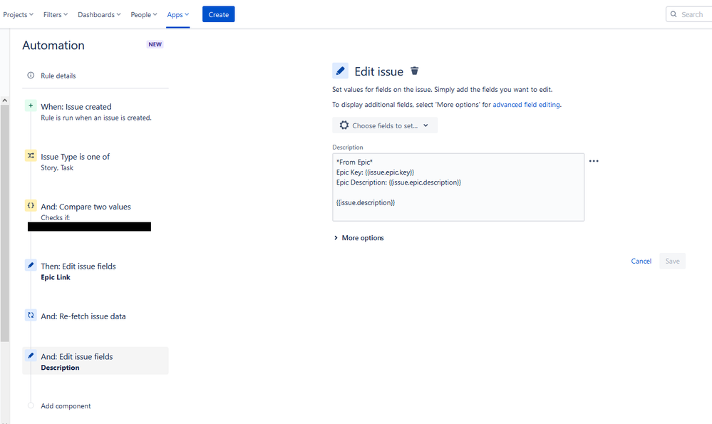

Understood the scenario. Please refer to the Automation rule screenshot below which will help you achieve the desired results.
To explain the rule, the story/ task is added to the Epic but since the details are not refreshed after adding the epic, it is not fetching the required details.

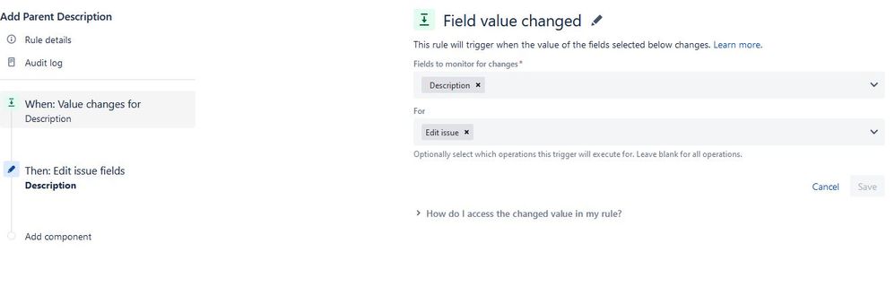

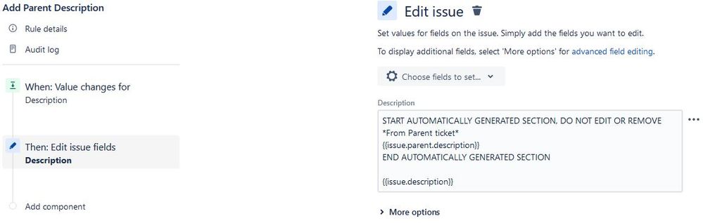

As per my understanding, you intend to append the description of a Task with the Epic Key and Epic description. I have done something similar where I have appended the parent issue description to the description of the current issue.
Please find below the screenshot of the rule which works. This can be customised to reflect the Epic details. Let me know if you need any guidance with the customisations.
Kindly accept the answer if this helps.

The epic link is added correctly, the problem I'm having is that the epic's fields are empty. As I mentioned in the post, I tried accessing them like this: {{issue.epic.key}} and {{issue.epic.description}}, but they are empty.
