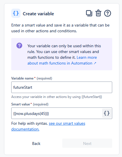

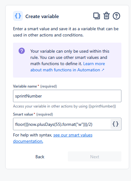

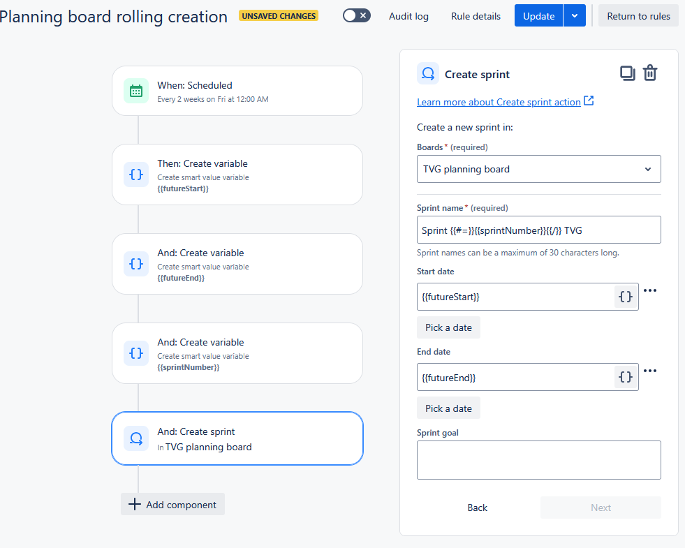

I couldn't think of a better way to share than screenshots. I used variables to set the dates and to number our sprints. We say that the sprint number is half the week number rounded up. The last step And: Create Sprint can just be copied and use different boards each time. futureEnd is the same as futureStart, I just add 58 instead of 45.
We create a sprint 3 sprints in advance.
