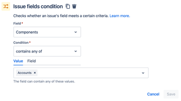

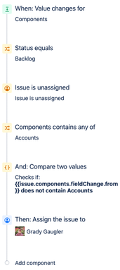

I'm trying to set up an automation for our workflow so that whenever an issue is assigned to our board (determined by component), it is assigned to me to review, prioritize, and ensure requirements are set.
The issue is that without diving into advanced automation syntax, the best we can do is to trigger when a component is changed and includes our team's component. That means that if another component is added on, it is reassigned to me despite having the same team component the whole time.
What I'm trying to do is find a way to compare the prior component value to see if only our team component was added (rather than just any).
Below is the current expanded workflow and what I've tried for this comparison so far. I'm sure I'm doing something wrong with the syntax. I found the {{fieldChange.from}} property but unsure how to use it.
Thank you for your help.
Screenshot 2023-05-19 at 2.53.21 PM.pngScreenshot 2023-05-19 at 2.53.30 PM.png

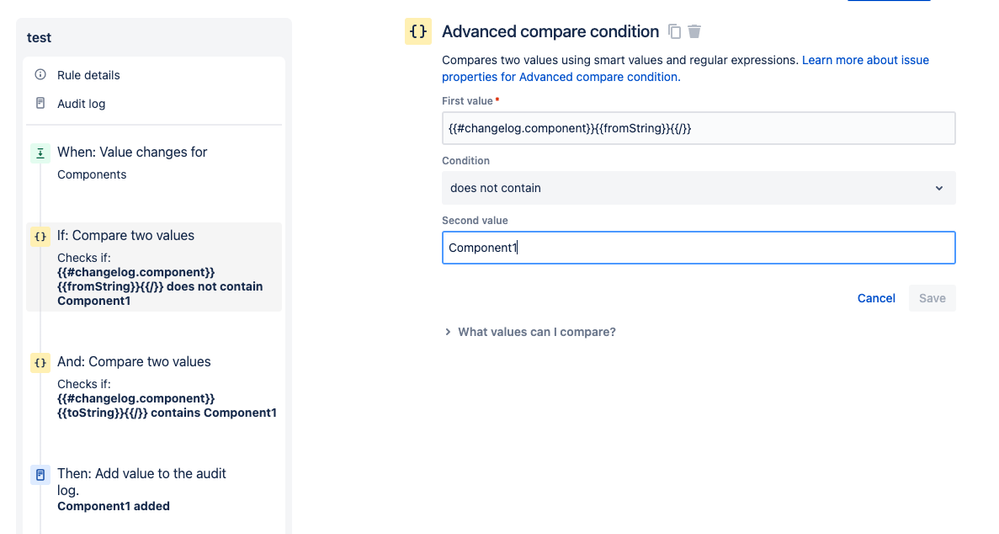

Hello @Grady
You can determine if your component was added by checking if it was not present before the change and is present after the change. In this example the component value I'm checking for is Component1.

Craig Castle-Mead
May 19, 2023
@Trudy Claspill  - this seems like a good approach. The only possible gotcha is that if a the component name the user wants to track is a substring of other components, they risk false positives.
ie: the component they want to monitor is “foo” - the pre/post check would also fire off a conponent “foobar” was added.

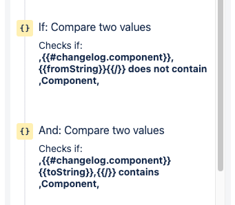

You can add commas to delineate the values of each Component. This will look for an exact match on the component named "Component". If "Component" is contained within the name of another component, that will not match these comparisons.

Grady May 22, 2023
Trudy and Craig, thank you both for taking the time to help.
I've implemented the last solution (both compare two values) and it works for the base case.
The problem that remains is component specificity. Unfortunately, the string is found in a number of other components which can be tacked on. So even after the main team component is added, an additional component would reassign it to me.
On the flip side, if one of those additional components is added as the first component (and not the team component), it too is assigned to me.
Any thoughts?
Trudy Claspill
May 22, 2023
Hello @Grady
Can you show us your current rule?
Also, can you walk us through a specific scenario with the specific Component values that are being added that results in you being reassigned the issue when another similar component is added? The last suggestion I provided, adding the commas, should account for what you described.
Like Kelly Arrey likes this
Grady May 22, 2023
Hey @Trudy Claspill, my mistake. I was referencing the wrong image. Now that I filled it out exactly as you had it in the second, it works flawlessly! Thank you for all your help.
