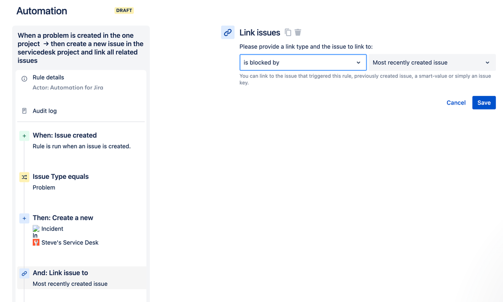

While I am having some doubts about your actual use case, you should be able to create and link a new issue using an automation like this:
When you add an additional edit issue action, you can additionally update the issue's due date using a smart value like this:
{{triggerIssue.duedate.plusDays(2)}}
