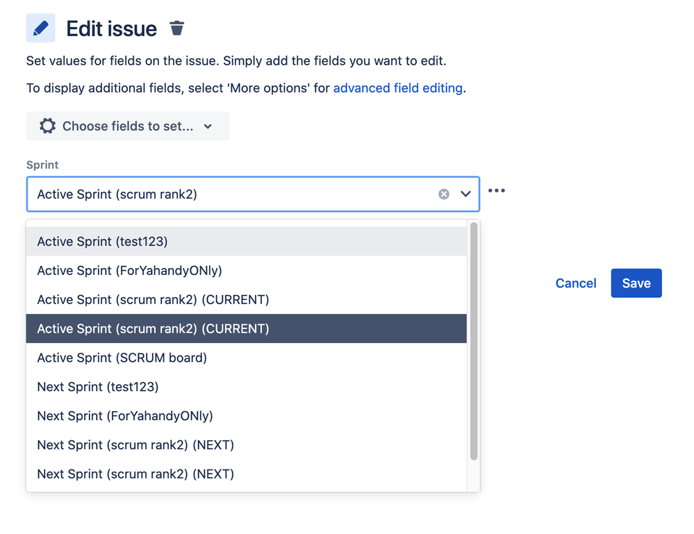

Automation can be used to set the Sprint field of an issue.  However within Automation, there currently is not a good means to differentiate between the multiple possible sprints that could exist on a board.  When using the action Edit Field, choosing the Sprint field, the options provided will include either the Active or Future planned sprint of every board available to that rule.
In the case of a project specific automation rule, this shows multiple entries when parallel sprints are enabled, like so:
In my test instance, the board (Scrum rank2) has two active sprints right now, but automation isn't being very clear as to which is which here.  You can't see the name of either sprint here.
Hence I don't think that automation is going to be able to easily set the sprint value here in the manner you suggested.
That said, it might still be possible to use automation to set the sprint a manner that it applies to a specific group of users, but in my suggested approach, this would require you to segment these teams into each their own board.  It could remain all within the same project, but having a separate board for each team could then at least allow you to assign to the active sprint of that team.  How this separation would work depends upon having some kind of field that clearly identifies that issue as belonging to that team.  If you can do that, then we should be able to setup a JQL filter to only select those issues.  Once you can do that, you can save that filter and then create a new board for that filter (presuming this a company managed project, as team managed projects don't currently let you configure the JQL filter for that board).
You could still maintain a board that contains all the issues from all these teams, but right now, in order to make automation able to accurately set an issue into the active sprint of a team, it needs that to be the only active sprint on that board in question.  Setting up a new board that only contains issues from that active sprint (and not any issues in a different sprint) could then help you to be able to create an automation rule here that could do this.

I do have separate boards set up for them!  I will try that! Thanks a bunch!
