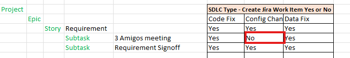

Once a story (for example) is created; 1 or 2 subtasks are also created based on the value of a multi-select field on the Epic issue, which the story is linked to.
This is the requirement of one of many tasks that I'll have to create this similar automation;
I have set up a rule that creates both sub-tasks above, but when the field
--> [SDLC type] in the EPIC (parent) is selected [Config Change],
            --> The sub-task  "3 Amigos meeting" should NOT be created.
So far that is what I have created and it is working well. (meaning both sub-tasks are automatically created, but that should not always be the case)

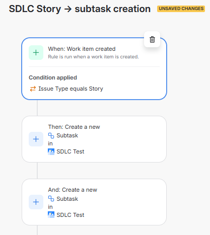

I tried to create a rule based on IF/ELSE block, but nothing seems to be working.

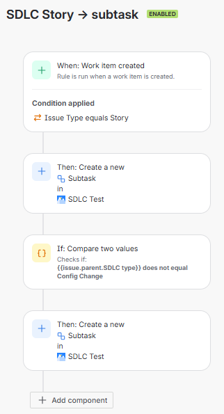

Hi @Paulo_Cerqueira
You will need to create a variable.
So when the Story is created, add a create variable action in the automation rule before creating the sub-task(s).
Name the variable and use the smart value {{issue.parent.SDLC type}} or {{issue.parent.SDLC type.name}}  to store the value of the SDLC type value of the Epic.
Then you could use IF/ELSE base the conditions on the variable being value x or y

HI @Marc -Devoteam-
Thanks for the explanation, it worked well after a few try, and it looks like that now;
 I first let the automation create all the regular subtasks I wanted and just then I add the condition.
Much appreciated your support on this...
