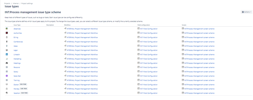

thanks for reaching out to me. Well the issue type scheme has few issue types as seen in the picture i have attached.Snímek obrazovky 2022-06-23 114210.png
Nic Brough -Adaptavist-
June 23, 2022
Ok, so you're definitely looking for something that you can't do.
A sub-task can be created under any issue type you have in the project.  The parent issue type cannot limit the sub-task types your users can create beneath it.  The issue types available to a project are done at the project level.
