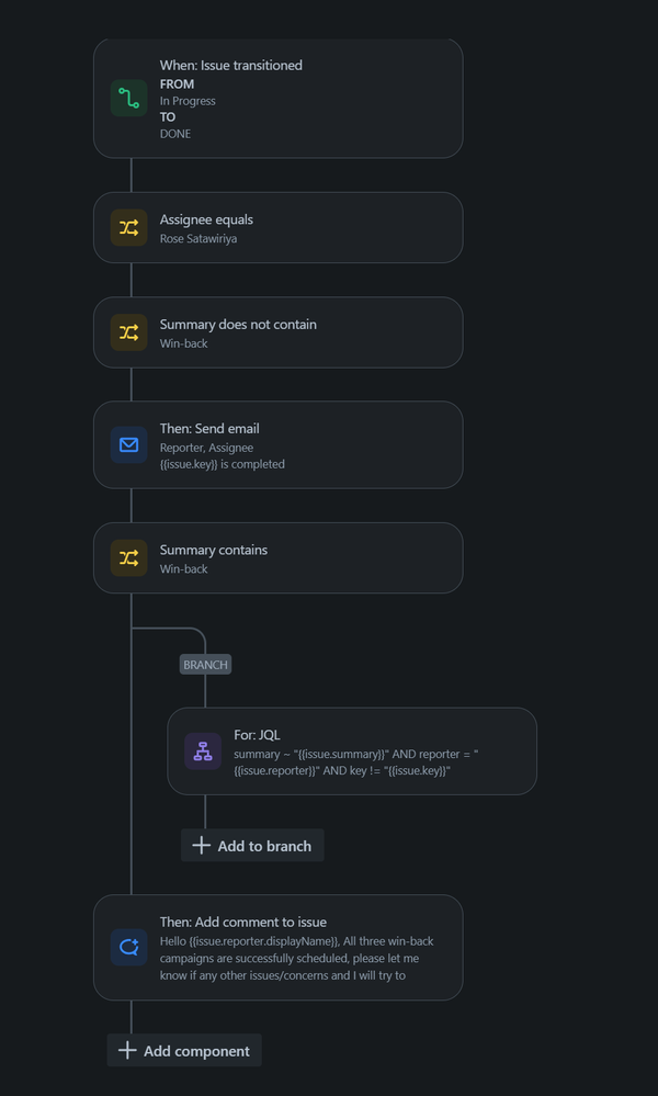

Hello @Trudy P Claspill  To simplify this for you, there are two scenarios of ticket response I want to set up.
1. Normal individual ticket, with the name NOT containing "win-back" in the issue summary - this I successfully to set up automated response once I close ticket, it gets sent to the reporter.
2. There are "Win-back" type of tickets, where it usually comes in a batch of 3 tickets ( with the same reporter) and instead of closing one by one, I would like to create some trigger that will send the reporter only one response while still have to manually set ticket status from "IN PROGRESS" -> "DONE"
This is some of the JQL I set up based on my internet search, but i'm not sure about it, also I only want it to affect the present ticket moving forward.
Thank you in advance, hope my explanation is clear to you.

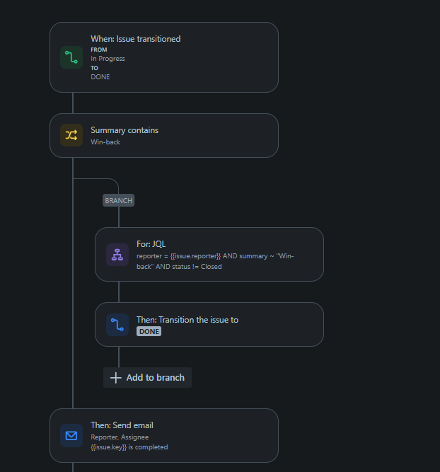

What I would like to achieve is as following:
1. The scenario is: Reporter will open three separate tickets at the same time, and my role involves completing the task specified on the tickets.
2. Once I complete the task, I usually organize my work by moving tickets to status 'DONE' so it's out of the queue.  This is the trigger I want to set. I wanted the rule to capture ticket with the name containing the word "win-back" to learn that if I close these 3 tickets when the task is done, send one email to reporter.
3. Since the three tickets from the same reporter will be done at the same time as well, I would like to notify just once, I am okay with transitioning the status of ticket manually.
Last week I tested the rule, and it seems to be working However, I would like to send you to help check again.
Just to clarify this, when the status changes (for non Win-back tickets) > it triggers the notification to reporter. For Win-back tickets, I googled JQL that commands the rule to look up similar tickets first, and even I close tickets three times, in my test it sends only one automatic email.
Let me know if it's unclear, or you think the logic doesn't make sense, thank you in advance :)

What I see in the rule above is:
WHEN: an issue transitions from In Progress to Done
IF: that issue has "Win-back" in the Summary
THEN: look for any other issues by the same reporter that also have "Win-back" in the Summary and where status is not "Closed"
-- Set those issues to status Done
AND: Send an email
One flaw that I see in the rule is that the Status you are using in the trigger and in the Transition Issue action is Done, but in the For JQL branch you are testing for status!=Completed. You should be using the same status value in all three locations.

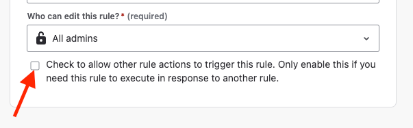

Another thing I would check is on the Rule Details page make sure that this box is unchecked
If that box gets checked, then the transitions that you execute in the For JQL branch will cause this rule to call itself again for each of the issues you transition in the branch.

@Trudy P Claspill  Hi Trudy, that is insightful. Thank you for suggestions, I guess your explanation is clear enough and that should resolve my issue. I will also uncheck the box you mentioned, thank you so much!
