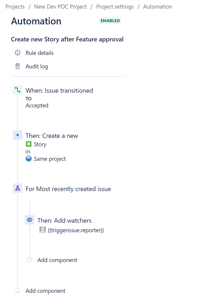

yaron
December 6, 2022
Branch to new created ticket and add watcher: {{triggerissue.reporter}}

Bill Sheboy
August 30, 2022
Ah, I believe that is a known issue.  The work-around/fix is:
  • clone your issue
  • branch to "most recently created issue"
    • add the watcher in that branch
