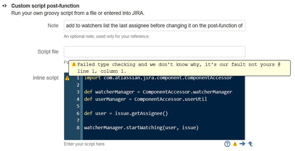

Hi Marcos, I copy/pasted your suggested script, but it does not run. see attached JPG

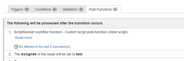

Anyway, I've checked on my Jira and it works fine to me. I attach a screenshot of my configuration (same as yours).
Sincerely, I don't know why it doesn't works to you, configuration is fine...

Hi,
It's not a script problem (as message says), so if you add it to the post-function and test it, it should work.
I recomment you to use a test environment or workflow to try it if you have one before implementing it to production.
Try it and tell me if it works.

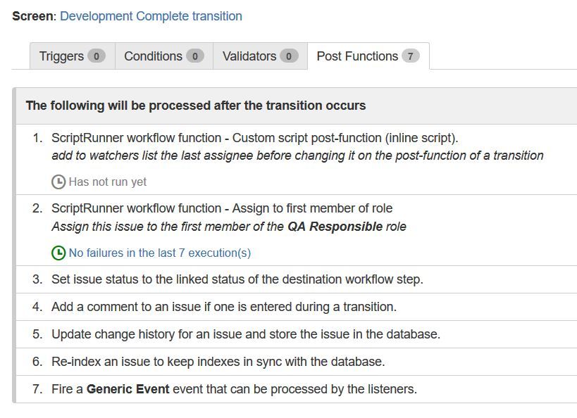

I did what you told me and created a new (first) post function with the script. See attached screen shot. If not this way, how shall I add your script?
Thanks again and best regards
Peter
Marcos Sanchez
May 9, 2018
Hi,
This configuration of the screenshot is fine.
I've just told you that the error that you get in the first screenshot is not a code error.
Did you tried to do the transtion and check if that all works?
Regards,
Marcos
Peter Kocher
May 10, 2018
Good morning Marcos
Yes, I added the script to the JIRA test instance and processed through the workflow. As you can see in my last screen shot, the post function says: "Has not run yet", so it did not process and I do not know why not.
Best regards
Peter

Peter Kocher
May 10, 2018
Hi Marcos
Yes, the workflow is published. I re-tested, added myself as reporter and assignee, removed all watchers and processed the issue through the workflow. In the transition, where the assignee is changed, I am not added as watcher. And the post function still says: "Has not run yet", so somehow it does not start.
Best regards
Peter
