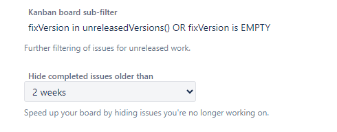

Then, please check the other settings for the board, like these. If you aren't worried about the version / release, you can clear this Kanban board sub-filter and update the 'Hide completed' to 'never mind'. It might just be the case you have issues that are mostly completed some time ago.
